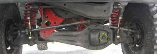

circled it .. i think thats it atleast ... haha im tired and heavily medicated ..
thats now solid axle thats TTB but i just noticed yours is a 98 so thats torsoin bars so0o0o ... you might have to pull the whole cover off
lemme search around on the net .. its to late to go climb under my brothers ranger .. someone may chime in before i figure it out tho
alright from the looks of things a fill plug should still be present should be about halfway up the axle houseing .. and you just pull it out and use a suction gun to drain the fluid and fill it back up till it spews out ..
Look on the driver's side of the diff. There's a fill plug about halfway back, about halfway from the bottom, so right about in the center of the diff looking from the driver's side. This is also where you fill it with more fluid.
