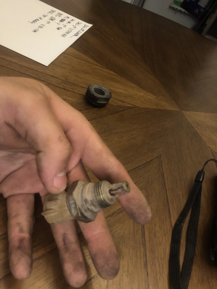

And also the air temperature flow sensor was just dangling out not plugged into anything could this be part of the problem?
