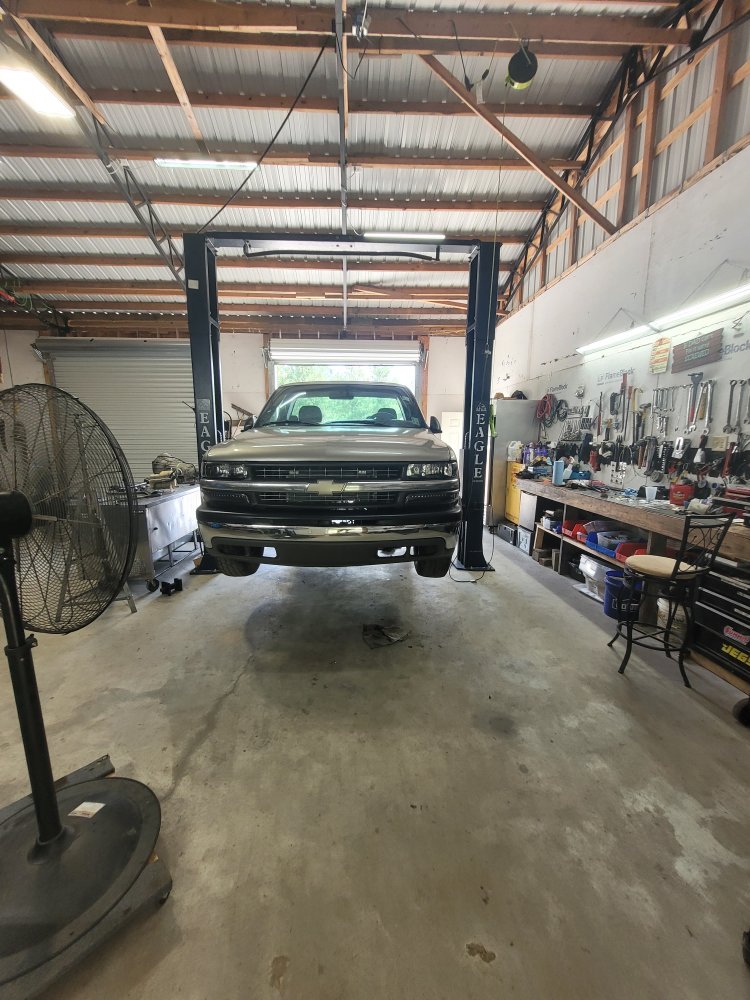

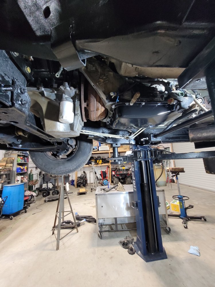

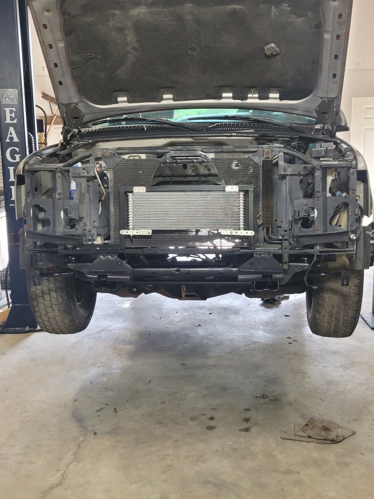

I know it's not a ford but all of us here love projects no matter what. Wife's aunt blessed me with this truck. 2000 silverado 1500. Had a blowed up 4.3. Got a donor 5.3 tahoe ringed the motor new rod bearings, btr truck norris cam with valve springs , speed enginerring long tubes, and got a 4l80e for pulling a 6.0 for the guy out of the same van. Goal is get it rurnning and driving and eventually put the 6.0 ho I have in it for a turbo. Put new lights and added a 40k trans cooler, electric cooling fan conversion. I still have some wiring to do but getting close.
