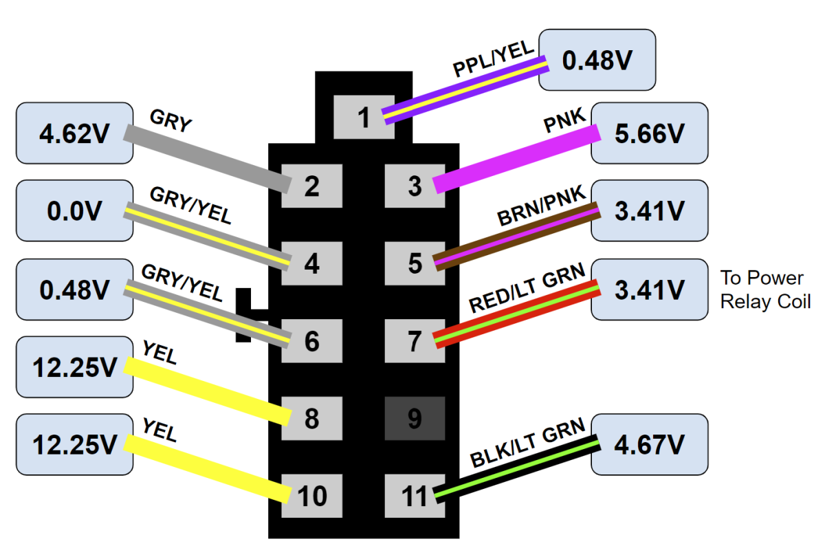

Hi all, I'm working on an engine swap in my 1990 B2. I just replaced the main power relay with an aftermarket one (cut off the old one and spliced in the new one). However, when I turn the key to "run" the relay closes its contacts as it should, but when I set the key to "off" and take out the key the relay does not go back, it stays active. I have to disconnect the battery to reset the relay. I have found that the red wire with a light green stripe going to the relay coil from the ignition switch has a steady 3.41V. So I'm guessing the 3.41V is not enough to trigger the coil but enough to keep the contacts closed after it has been switched.
My main question is, is the constant 3.41V on this circuit supposed to be there? Also, where could it be coming from? I'm kind of stumped here on my project until I get this relay to operate properly.

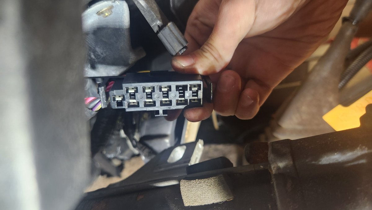

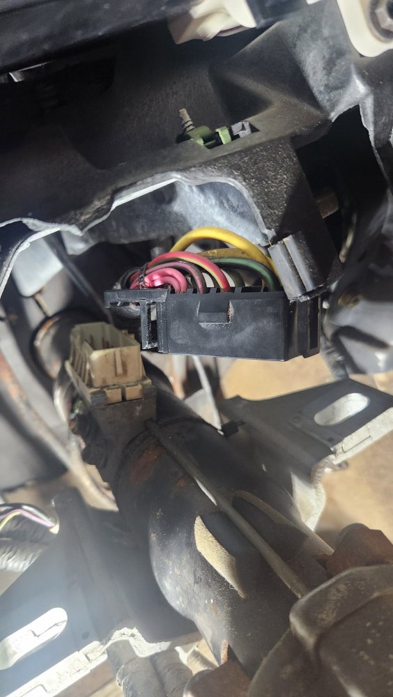

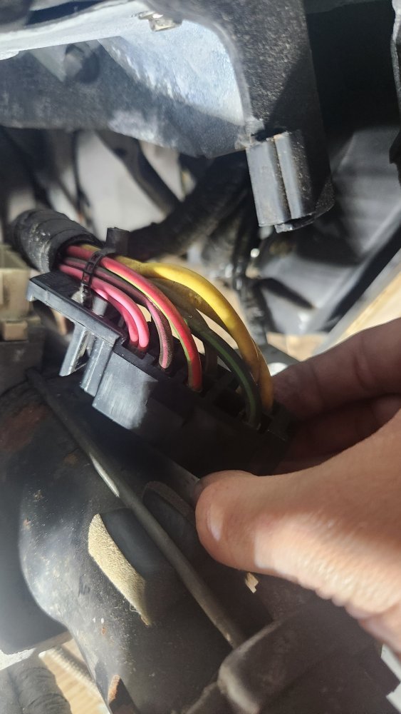

Also, Upon investigation into the ignition switch there are many different wires with odd voltages when the key is off. So if someone could shed some light whether these are proper voltage readings I would be much appreciative.
I've attached photos and diagrams below. Thanks again for your help!

Haven't had the first start up on my engine yet. Also, there is no alternator wired in yet so its curious where the low voltage comes from. What else could generate a voltage? Capacitor? small battery somewhere?
A poor ground somewhere can cause it. Poor grounds cause all sorts of problems. The only way to logically find out what is causing it is to disconnect things one at a time till the voltage goes away. You can usually use the fuses for this, disconnecting parts of the electrical system till the voltage goes away.
Good idea. I'll see which fuses affect the voltages in the ignition. Was trying to trace the wires back but that was getting difficult.
The 40A headlamp fuse is the one responsible for letting the 3.41V pass through. Not sure how the head lamps are tied to the main power relay.
