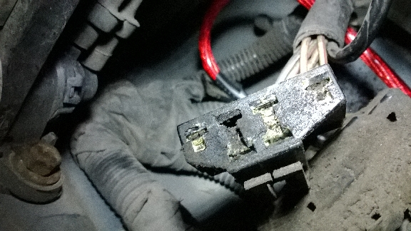

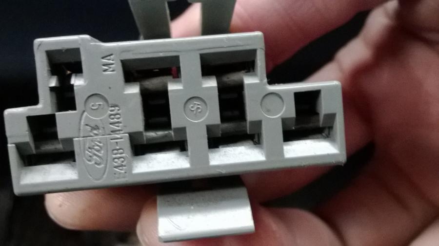

Weird EEC/ECM Plug 90 Ranger
connector
that is in fact the doorchime/headlight chime plug i googled the number and thats what it came up as lol

Should be drivers side fender back towards the hood hinges
Sent from my SGH-I747M using Tapatalk
Thanks, found it, jumped the relay, pump is completely dead. Replacing in tomorrow, hoping that's all
