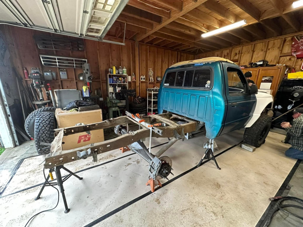

This is how the truck was previously and a few of the parts going on it

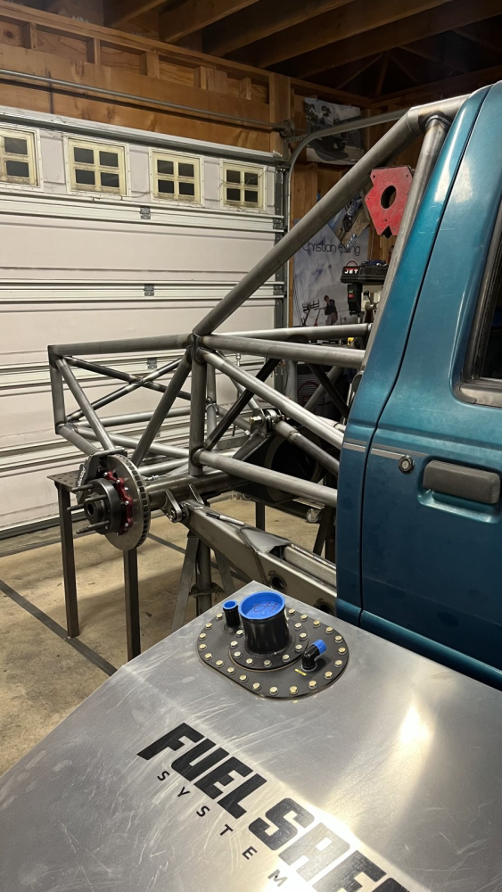

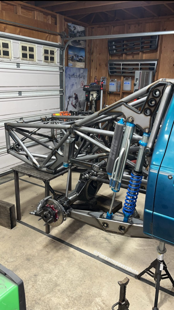

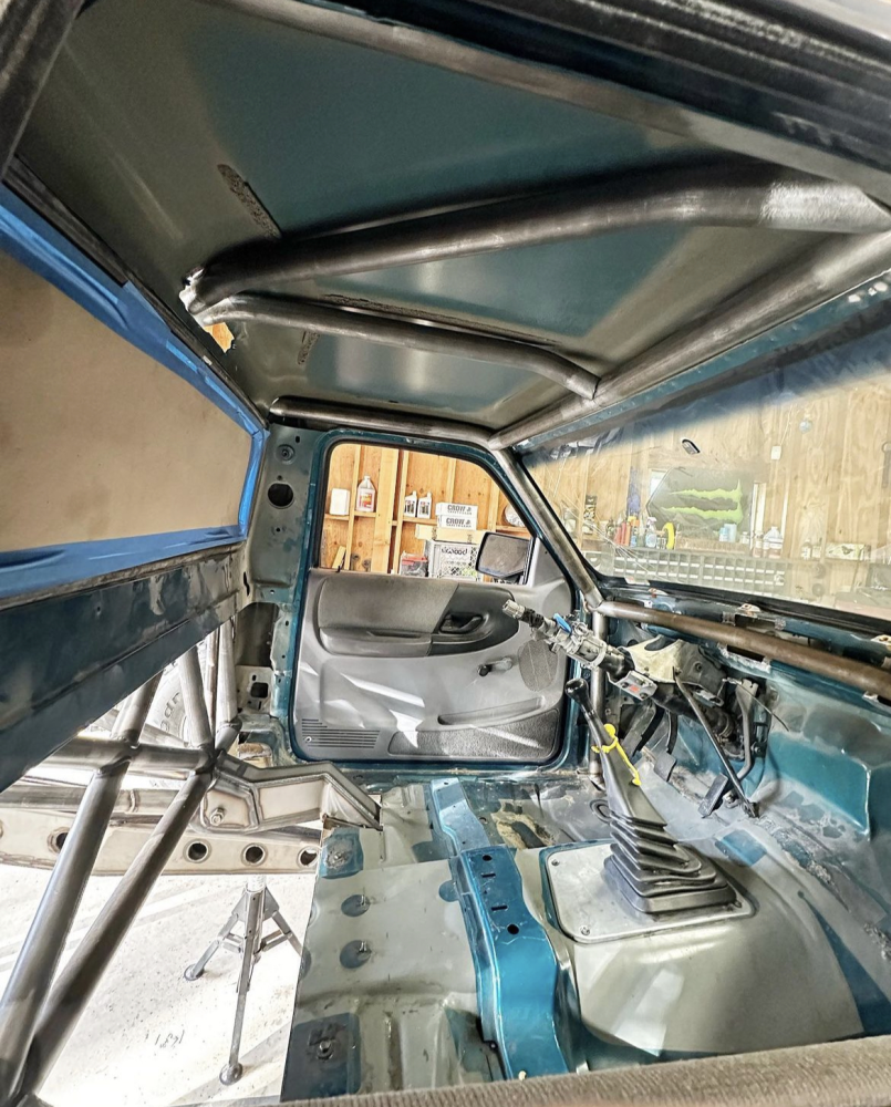

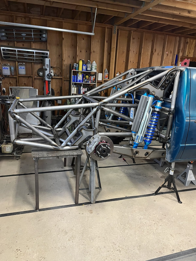

When the truck got here, the first thing I started on was the cab cage. I got the main structure in the truck (whole truck is 2” .120 DOM mains with 1.75/1.5” .095 DOM stringers) basically just enough to where I could start on the external B pillar outside of the back of the cab. The reason I went with an external B pillar is because I knew with this being a regular cab we were going to start running out of room quickly, especially with helmets on. Safety is priority number one, so I did not want to have any tubing close to heads in the truck. After those tubes were ran, I got the frame cut off around the cab of the cab and the 4 link pivot boxes in place, those hold the VD trailing arms attached to the Camburg 3.5" housing, and then got the B pillar tube structure in place and the front section of the backhalf built up until the axle housing

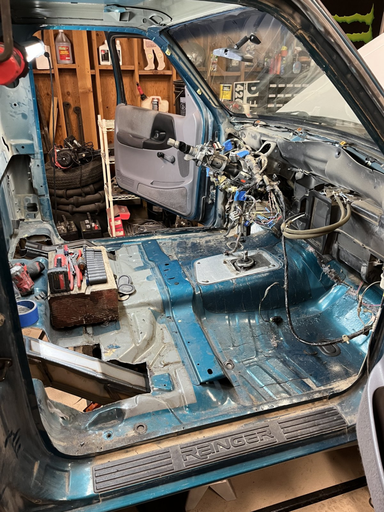

Getting stripped down

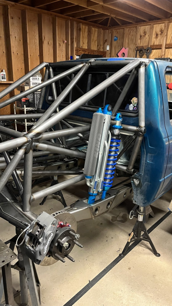

Cab cage structure going in, making sure all the tubes are tucked as tight as I could for the most space possible in the end
External B pillar going together
Front section of the backhalf up until the axle

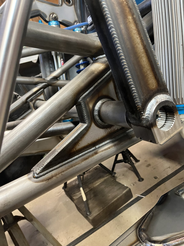

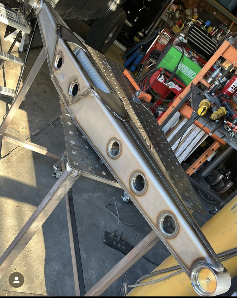

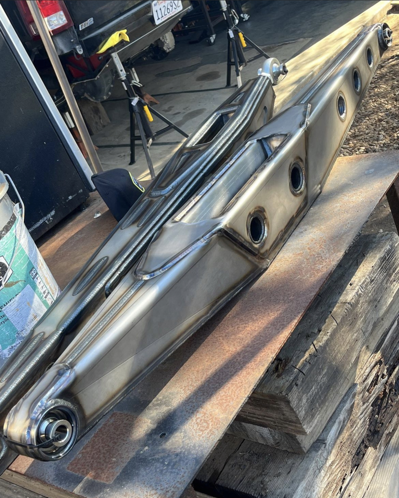

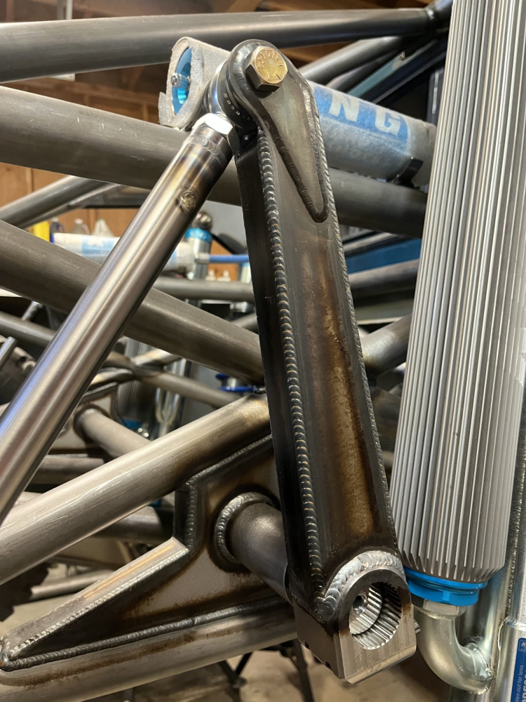

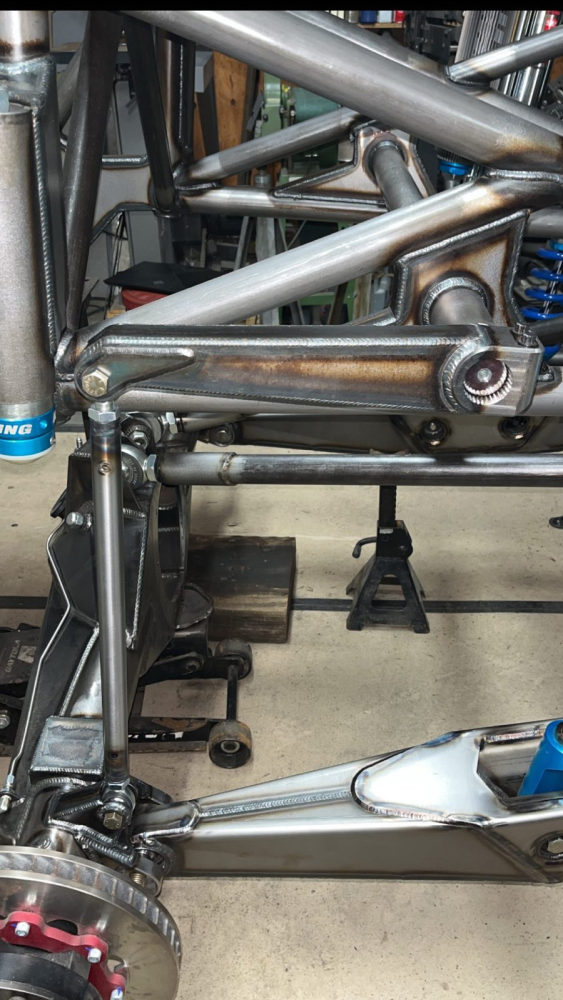

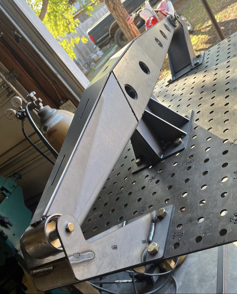

My own designed and fabricated trailing arms. These are cad drawn, laser cut and bent and then fixtured for a precise fit and finish. These are something I offer to the public along with some other parts as well

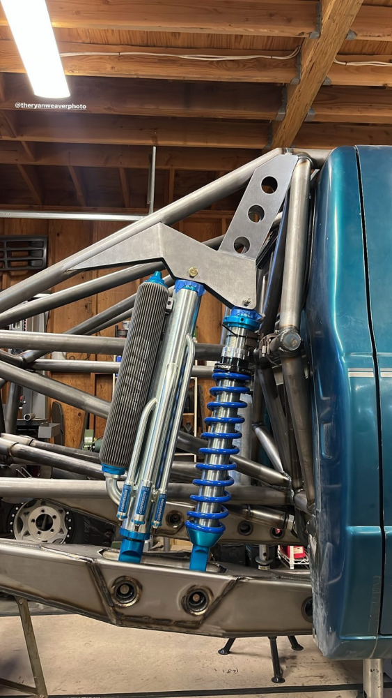

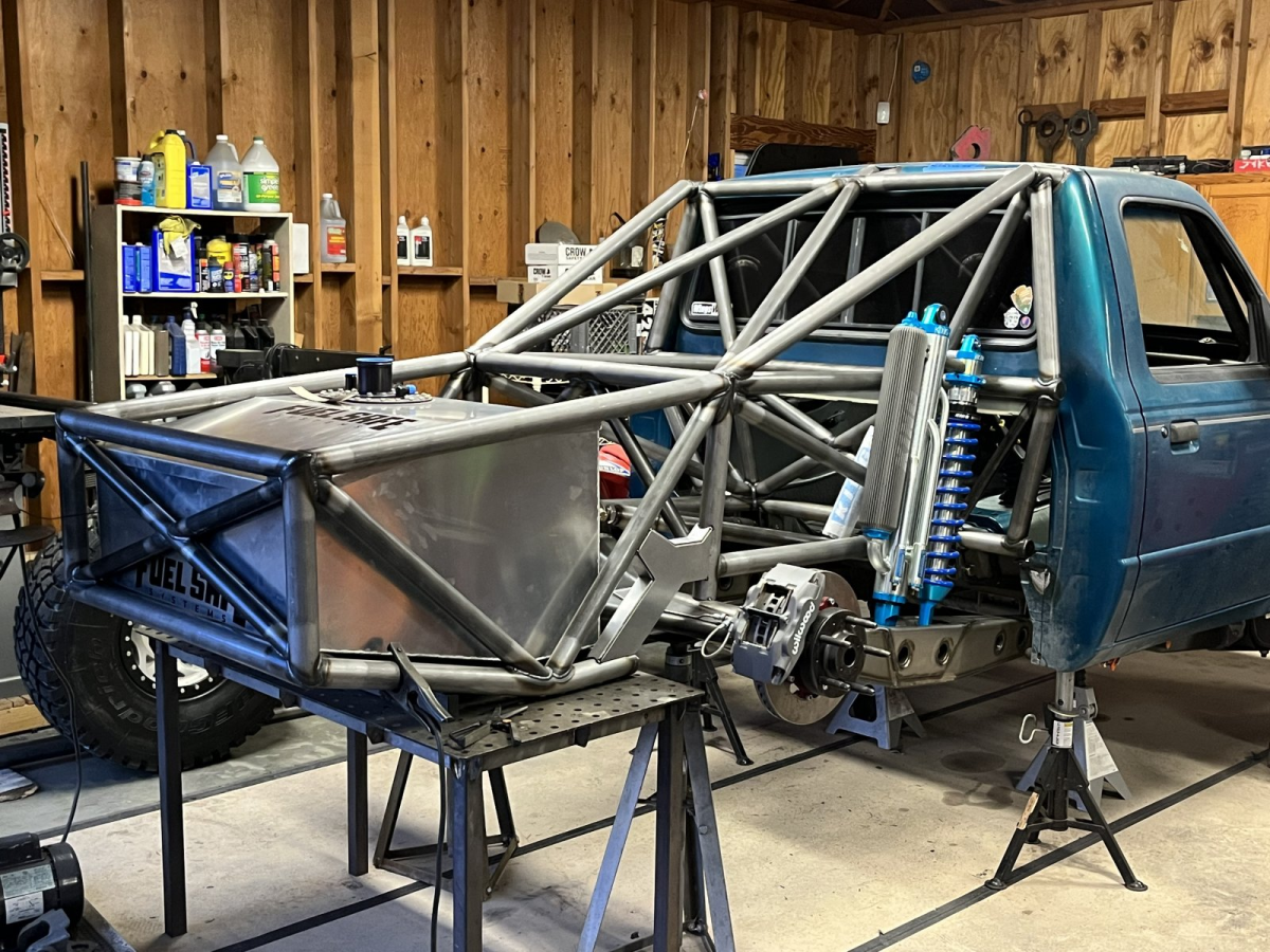

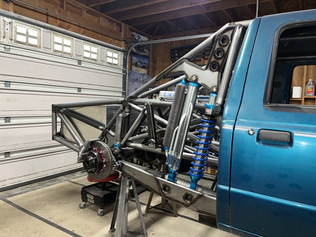

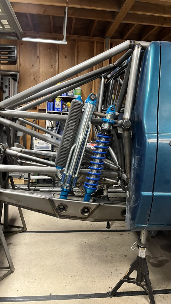

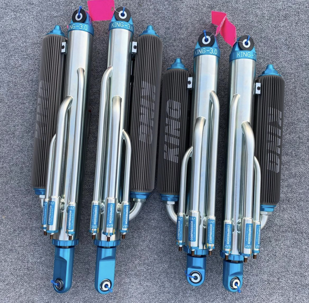

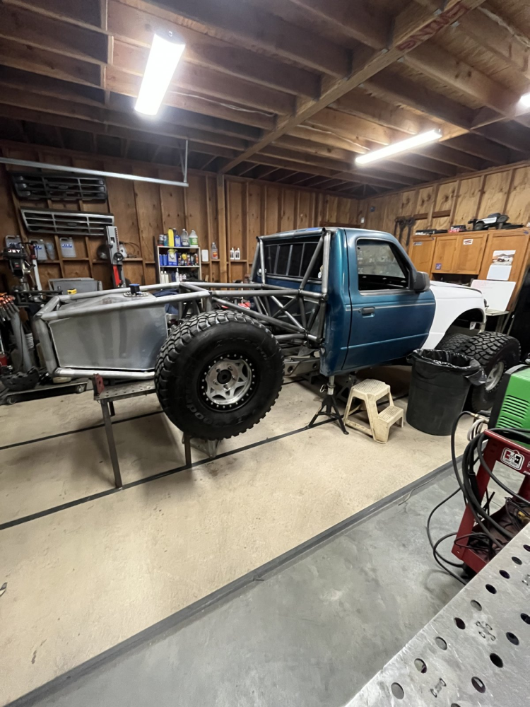

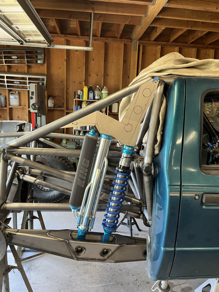

Next the backhalf started going together, the 50 gallon Fuel Safe fuel cell found it’s home behind the axle and shocks started getting mocked up to start on shock mounts. This truck is running a full King Shock package from the boys at DownSouth Motorsports in San Diego. The rear is running a 2.5x16” PR coilover and a 3.0x18” RS 5 tube overlapping layout piggyback bypass. I did make the mid compression tube on these the bigger 1” diameter, as well as a bigger diameter resi port off the body to help a bit with fluid flow for chatter bumps and Ryan balled out on the finned resi’s

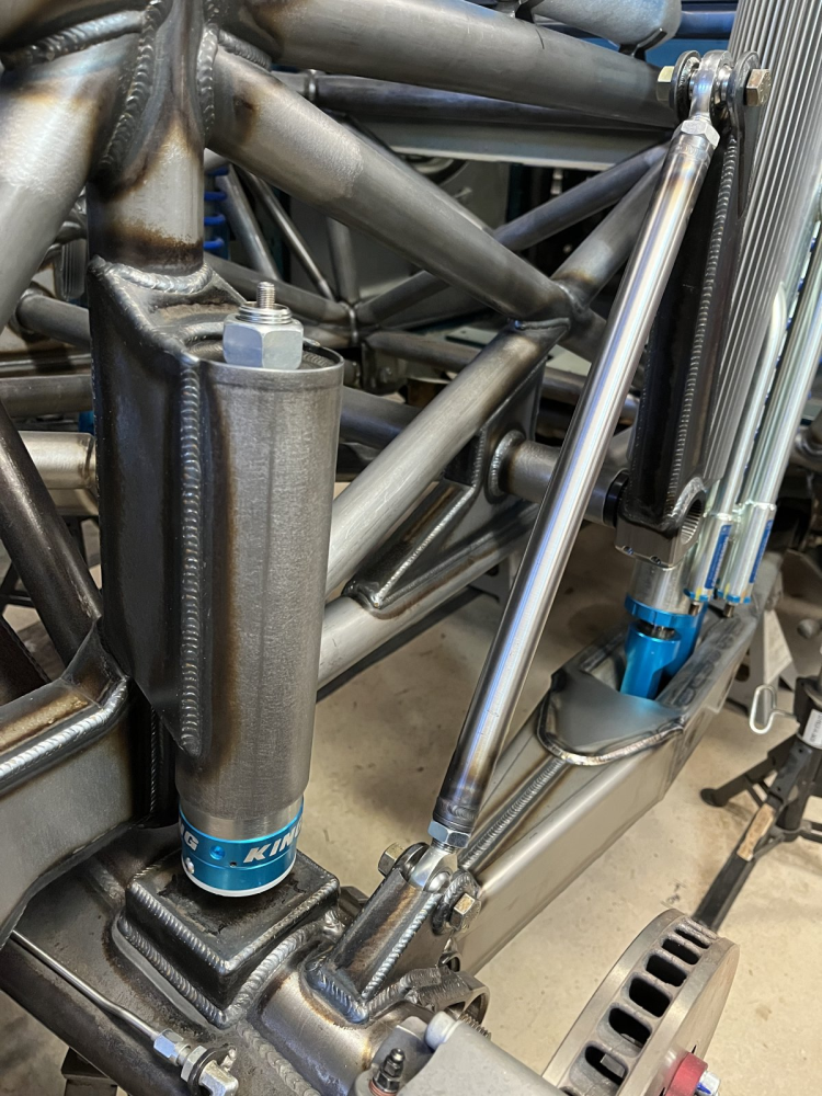

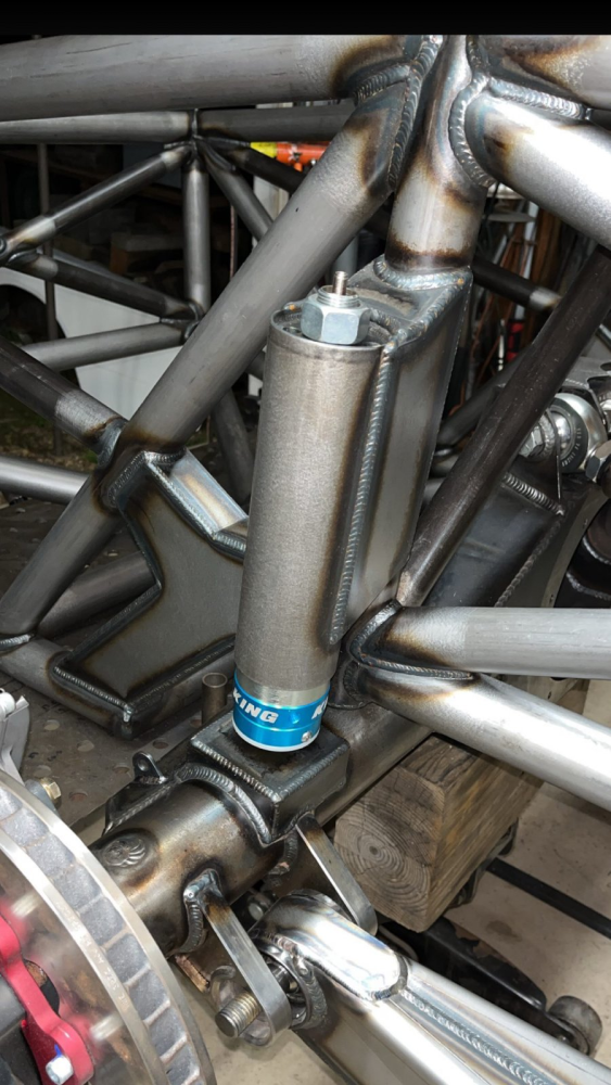

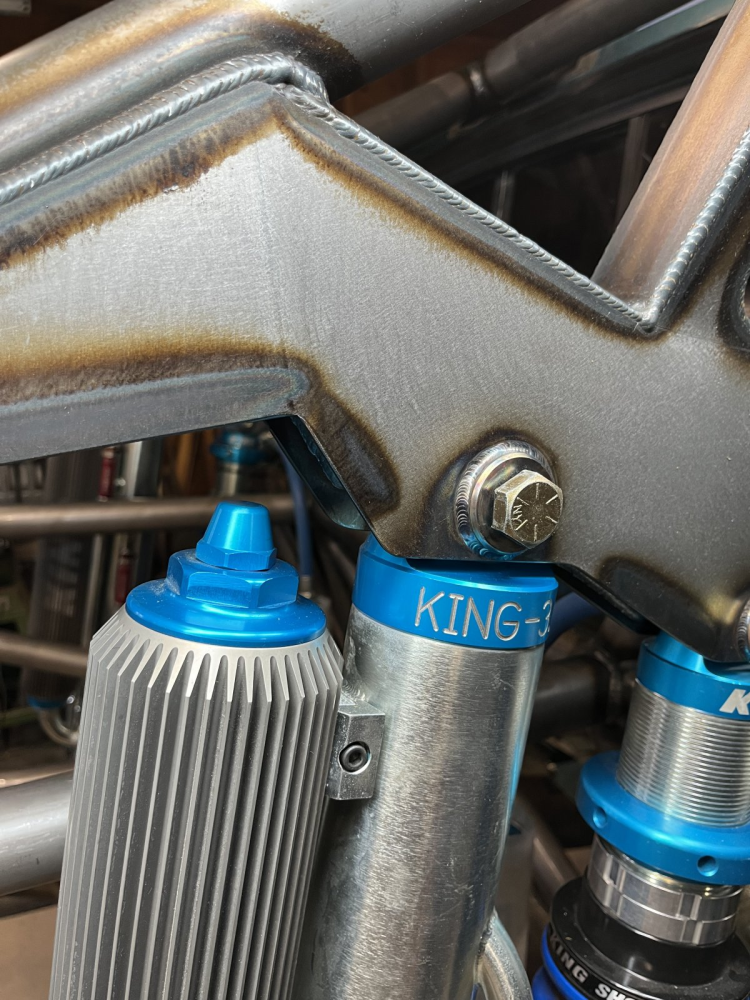

Shock mounts got done, as well as the lower plate structure tying the fuel cell cradle into the front section of the backhalf. This truck has a theme going through it of 3 holes, weather it’s on an overlay or a through hole through things. All my trailing arms run 3 thru holes in the front, the shock mounts have 3 holes in them, the pivot boxes have 3 holes in them on the overlays as well as other stuff that’s not been posted yet like the jack mount, fluid containers, trans mount, fuel cell hold down. Also got a few more tubes in the backhalf

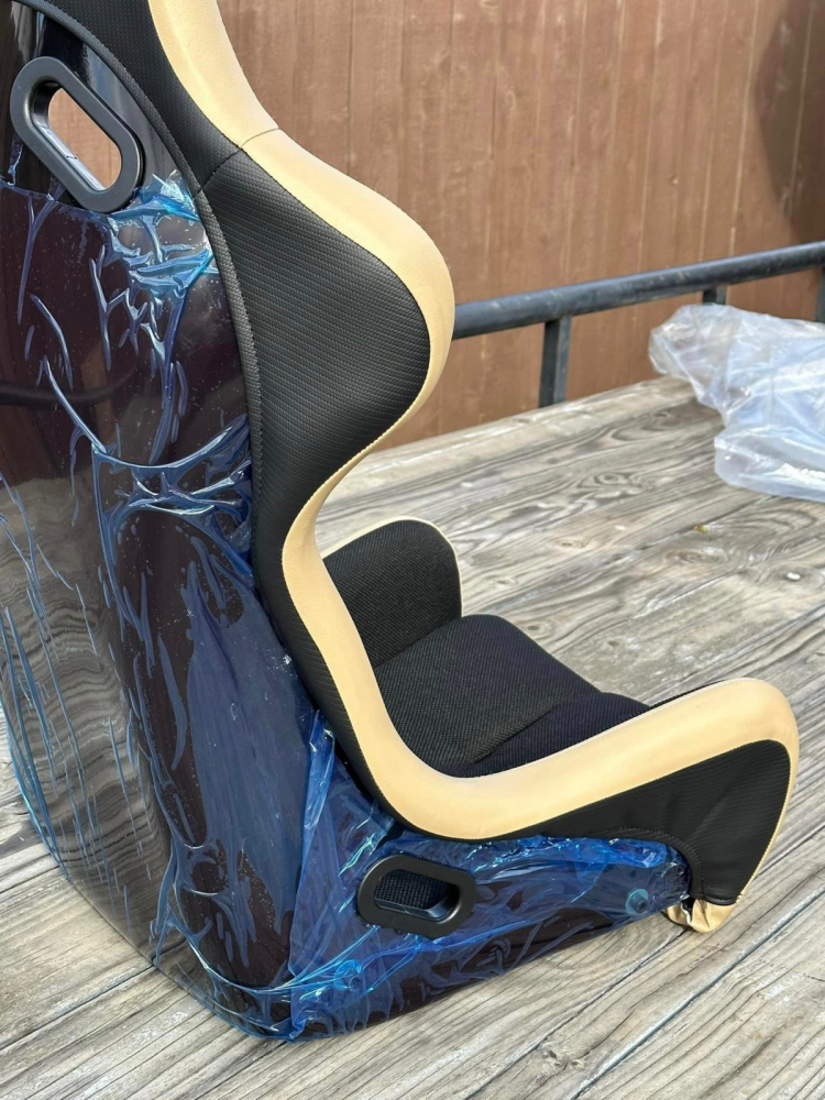

The door panels may be staying, im not 100% on it yet. I just got done fitting seats and door bars and everything clears the factory door panels still so we will see what he decides he wants to do

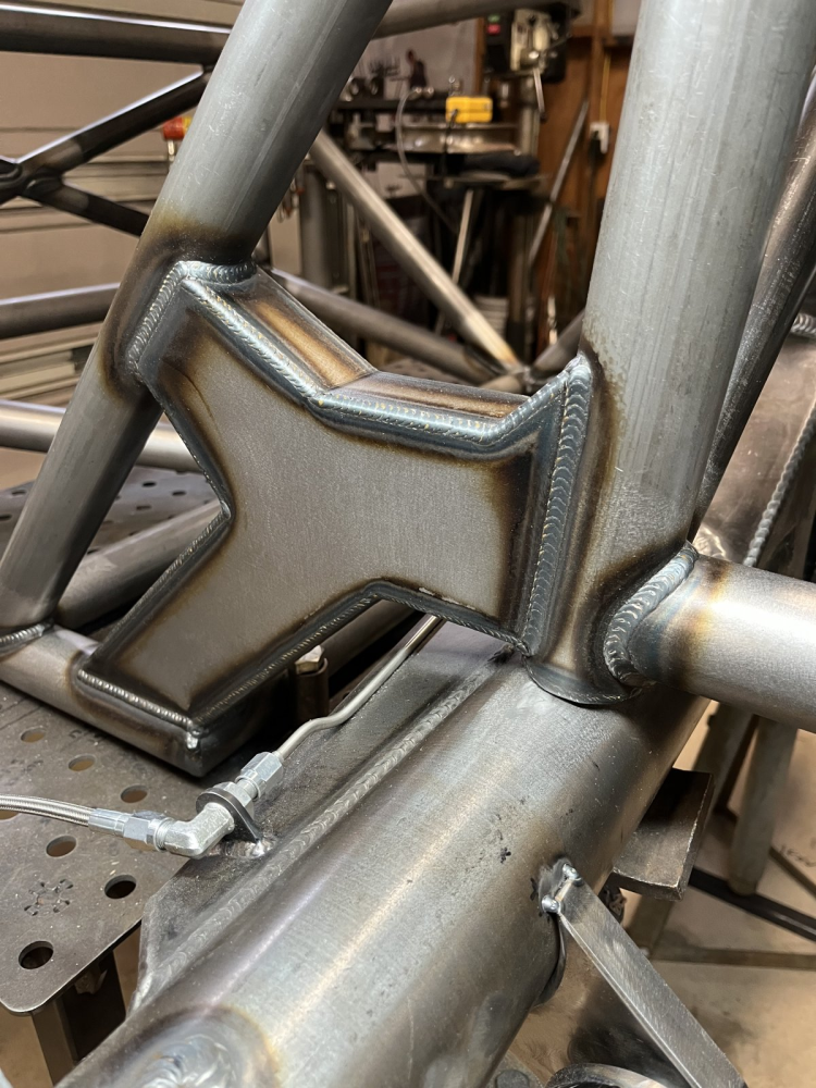

Next was bumps and sway bar setup. Things got kinda tricky with this. When the housing was ordered, the plan was to run the camburg unequal length kit it had already so we set the overall width of the housing to work with that. The track width on the rear of this truck is 76” OUTSIDE TIRE to OUTSIDE TIRE, not WMS. The space I had to work with for sway bar and bump stops is tight. Another original plan was to do dual stand up spares on each side of the fuel cell. Both of those situations is what dictated where the sway bar went on the chassis. I built the arms myself, using the DIY Off-road machined splined sections, the arms are 13” long to package in between the shocks and the bumpstop. The linkages are running FK HRSMX8T heims since they come with built in misalignments and the mounting width is perfect for swaybar stuff. The truck is running a 1.5” 35 spline torsion bar, with how short the arms are I’m curious to see how this thing feels. I may end up machining the bar down after we drive it to soften the rate up a little bit. There was no possible way to get the sway bar to pass between the bumpstop and the inside of the tire to make them longer in length, which is what I would have preferred because of it helping with leverage as well as not limiting the travel numbers on the rear end. I got away with it on this setup, but I’m using the entire throw of this sway bar to the extremes of almost binding at bump and almost overextending at droop and going straight with the linkage. The bumps being used on the rear of this is a 2.5 diameter by 4” stroke

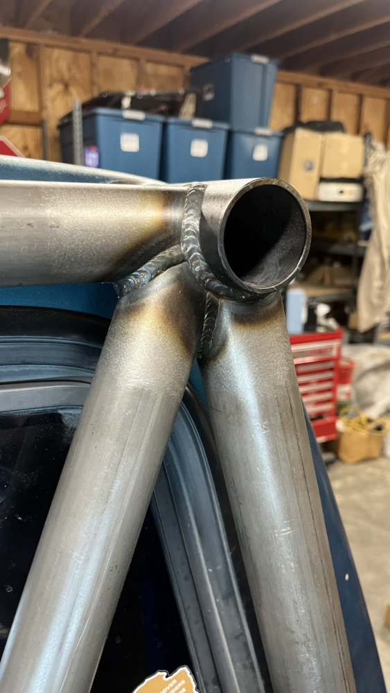

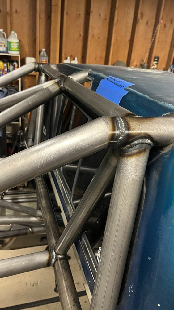

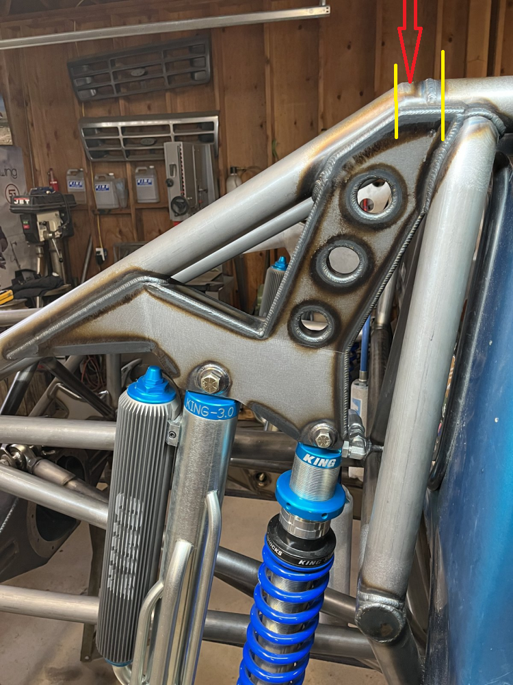

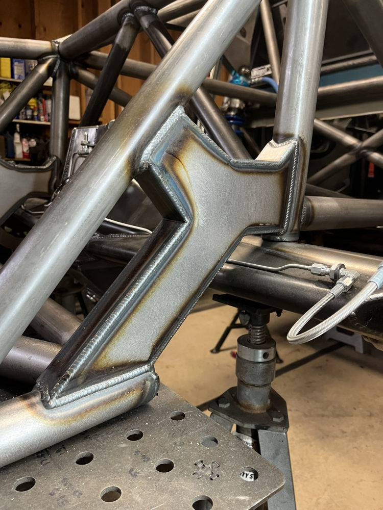

can you explain what is happening here? the small 1" - 2" piece. Is it a small section welded in, or is it bent. I only see weld on the front/cab side, and I couldn't image you would grind the weld down.
I misjudged how far to stick the main tube that comes out of the cab when I was originally doing the cab cage. I have never done an external B pillar like this truck before and thought I left myself enough space to be able to miter the main tube later when I was ready to get the down tubes in, but I realized that wasn't going to work once the B pillar got built haha. The miter is blended out so you don't see the weld, there is a internal rib (1/8" plate that sits between the two pieces of tubing) that gets put in and then the weld is getting full penetration on the entire joint before getting blended out. And then where its spliced into the main down tube, there is a 1.75" .120 tube that is sleeved inside the joint to make a good bond between both 2" .120 tubes with rosette plug welds on each side. With the shock mount coming up and getting welded to that entire area its strong as shit. Visually though it still bugs me knowing I didn't calculate it correctly HAHA wuuuuuutever
Thank you for explaining that as thouroughly as you did.
