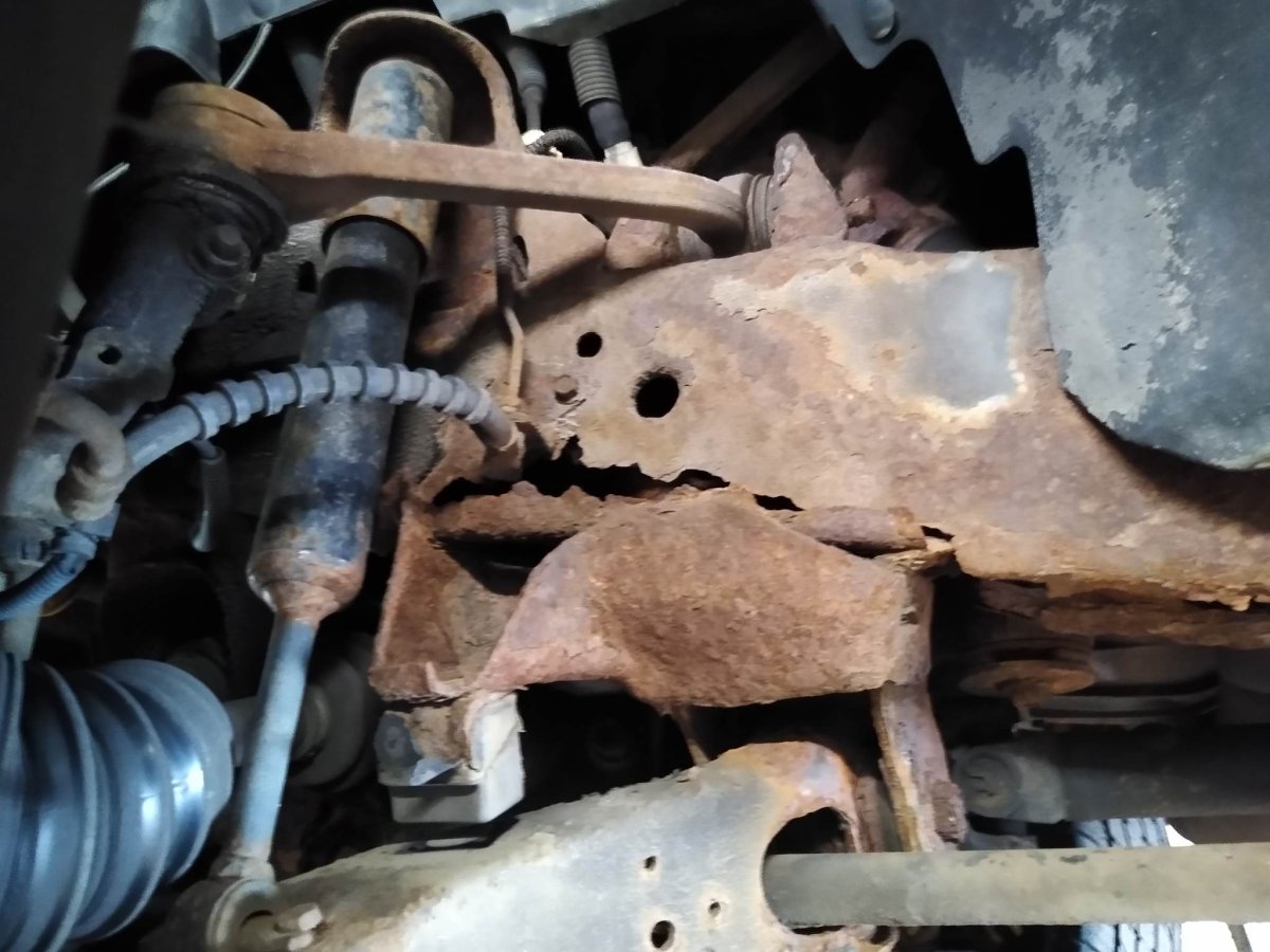

Thanks for the input guys. I found the problem...And it's BAD.
Time to find another Ranger. :(
It looks like frame or frame member is rusted apart. Would have to rebuild that section? But if it's that bad this might not be the only place it's about to let go. Sorry to see that.
They didn't have that on the list.... "Frame is rusted apart" I guess they figure you'd see that. Maybe it falls under "improbable, but not impossible".
wow, good thing the torsion bar is still there as it's all that's holding the lower arm in place.
Yeah, the rot goes way up and across. That lower mount is completely separated from the frame. It's a goner. It's a shame because everything works. That's how it goes I guess, I'm just glad my wife wasn't hurt driving it.
OMG, sorry for that discovery. At least no one was hurt. Might be a good idea to check the frame under the bed because usually the rust is worst there. If it's bad enough, you should get it hauled away instead of even driving it to the salvage yard.
