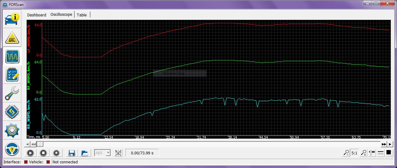

Its nearly impossible to get a graph of the ABS sensors when it is activating - which starting today it has a new issue. I can hear the pump buzzing around 45mph when my foot is off the pedal. It goes BRRR for about 10 seconds then stops. I did uncover what appears to be a failing rear axle sensor though.
The peaks in the rear wheel speed sensor graph are indicating there is an issue there but it is still unknown if the the sensor is going, tone ring has issues ( i wouldn't think so unless that differential had issues at one time like chipping a gear or grenade the diff gears) or wiring/connection issues going from the sensor to the module. But progress has been made since you have found an issue there at the rear.

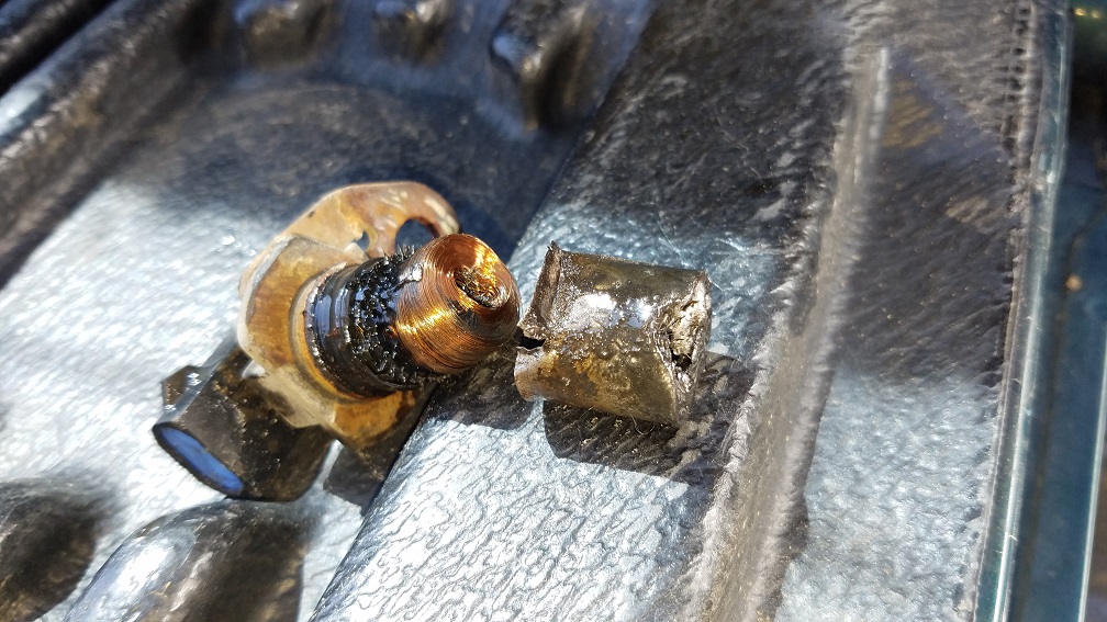

A week has gone by, and the problem HAS BEEN FIXED! The sensor came apart, looks like it had an impact on the bottom. Unsure if this was the cause, or if the casing from the sensor began to fall in and struck the tone ring, causing the complete failure.
Just installed a new sensor, truck stops like new!
If anyone has a C1102 abs code, get your hands on a OBDLink MX (usb OBD2 adapter) and download Forscan to a laptop, take a drive and graph out the speed sensors. Mine had an intermittent drop out, each time the signal dropped out the ABS computer thought the truck was slowing down and would activate the ABS. Very weird indeed.

Some useful information I found out while fixing this problem. The 7.7 and 8.8 rear ends both use the same speed sensor (aftermarket from autozone). If the rear speed sensor is disconnected, the ABS will estimate vehicle speed based off of the front wheels. Problem is, its not accurate, like at all. I was doing 65 according to GPS, speedo said 70ish. When actual speed is 100mph, speedometer recorded 110mph, and speed limiter kicked in. Pretty cool that the speedometer still functioned with a dead rear axle sensor. What was really interesting is it changed my shift points and made it shift sooner.
