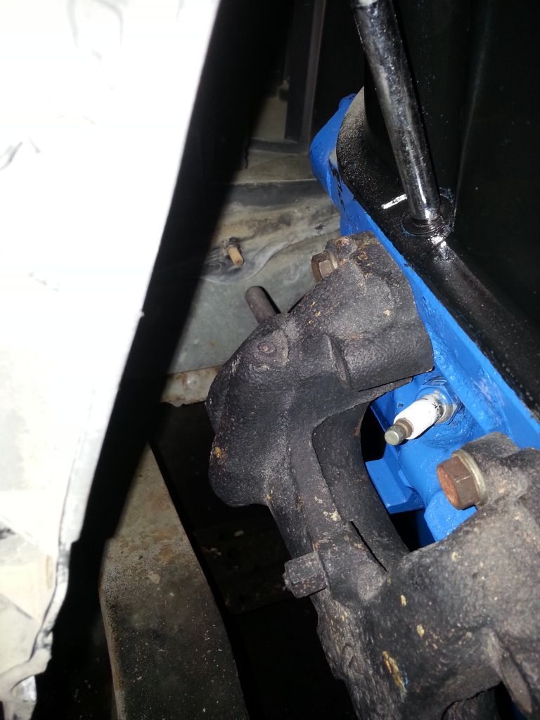

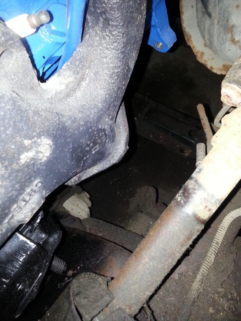

I am doing a 302 swap in my 85, i am using 289 manifolds with a 3 inch body lift. They seem like they will clear everything fine
Here is the driver side
passenger side (this was before the body lift and before i drilled and slotted the crossmember for the motor mounts, so it looks like it wont work)
