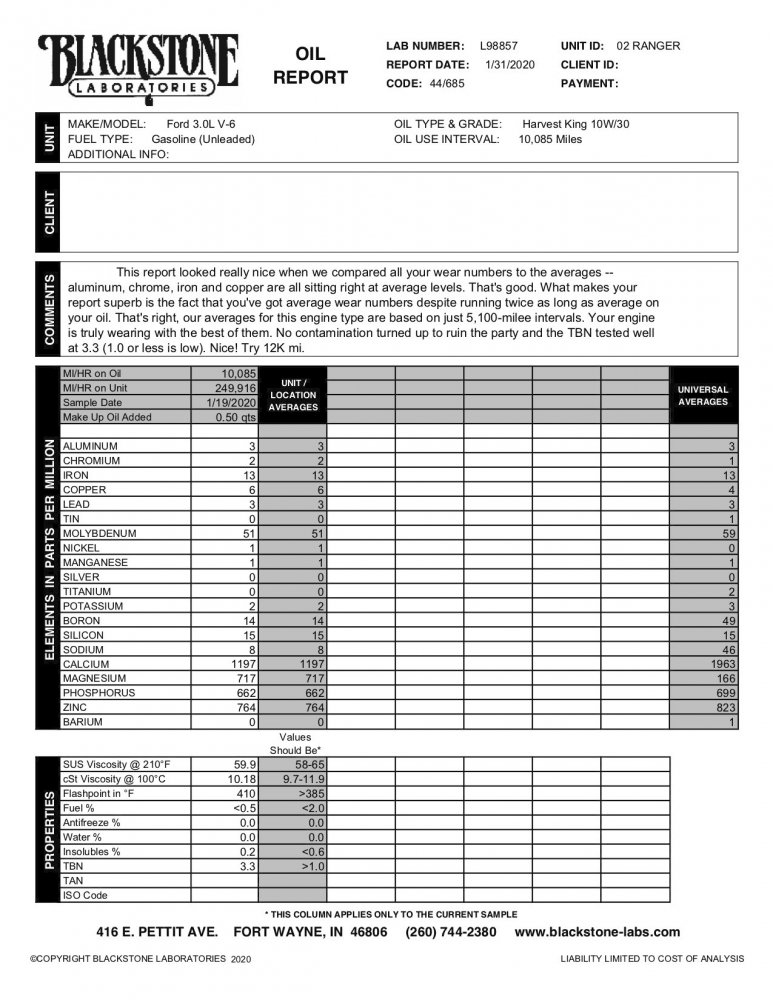

At my last oil change, I sent out a sample for analysis.
First time and likely the last time I will ever do this. For the cost of 3-4 oil changes, I found that my engine is wearing slightly less than average and the oil had some life left at 10k miles. Whoopee.
Anyways, here you go. It was my 2002 3.0L, 10k miles and 5 months on Harvest King 10W-30 synthetic with a Bosch 3422 filter.
36707
Cost the same as 3-4 oil changes? Dang. I'll analyze my own. If it doesn't come out chunky, must be good.

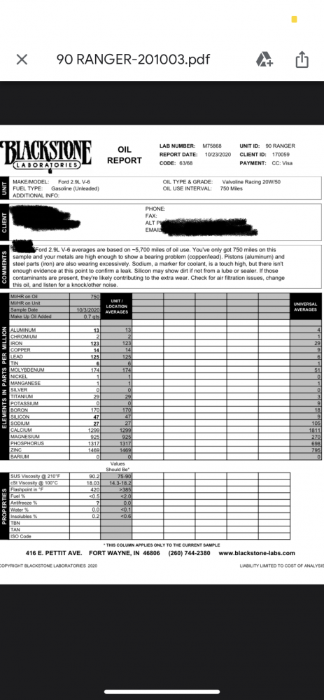

I just did my oil analysis. It’s a 1990 2.9L I track race. Looks like that 302 swap may be needed sooner than later.
That's normal for a 2.9...
:icon_rofl: It says listen for knock or other noises from a 2.9L!!! Even the oil analysis company knows.
Curious what they would diagnose my poor 2.9 with...
Even a knocking 2.9 is superior to a 3.0.
