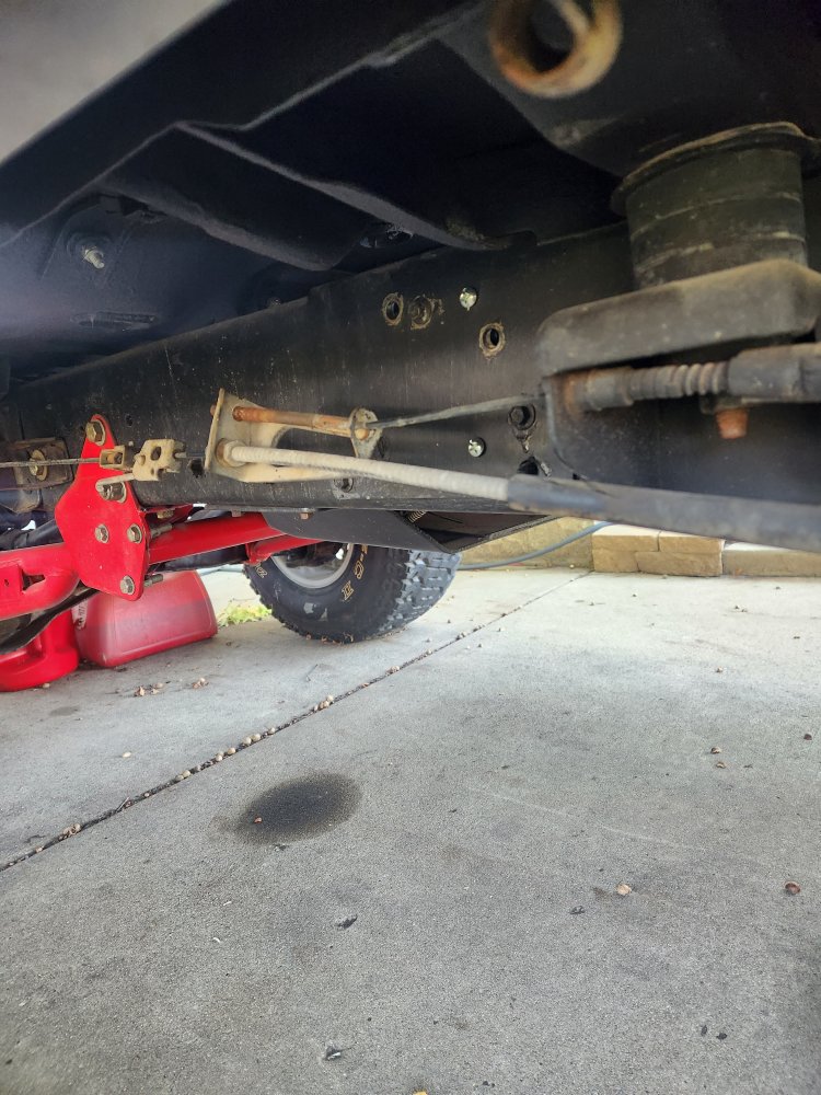

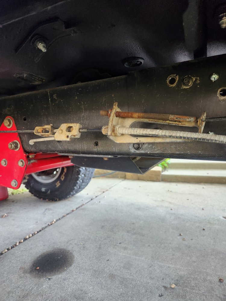

I need pictures of the Bronco II parking brake cable routing and connecting parts from axle cables to front cable. I have the front cable, and new rear cables, but when the axle was swapped into my B2 15ish years ago, the cables never got connected.
Here's what I have for a 1990 B2.

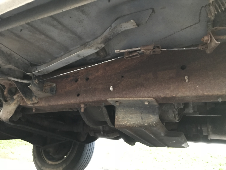

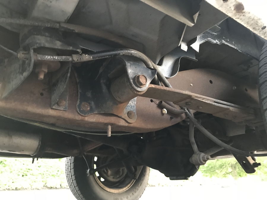

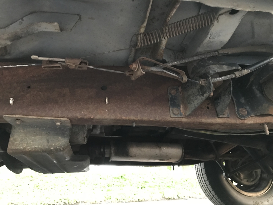

@Uncle Gump 's is an '86, I think, and a lot cleaner than mine. Mine are functional, but I'm not sure if anything was changed before I got it (had it 17 years).
It looks like '86 and '90 were very close, if not identical, so hopefully the pics should get you in the right direction.
Mine has an Explorer 8.8 and disc brake conversion. Not sure those pictures would help you.
I will add that my set up does have the return spring that connects to the equalizer as depicted in @RobbieD second picture. It was disconnected and I didn't connect it before the picture.
