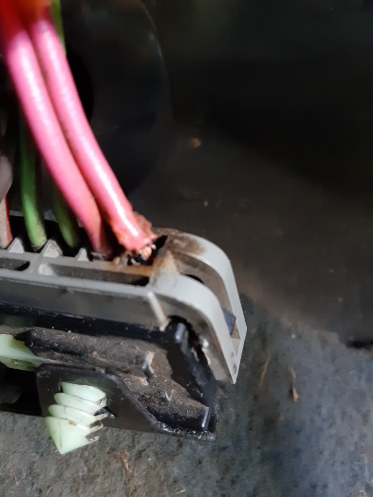

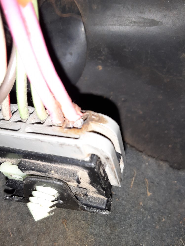

I was under my dashboard trying to troubleshoot my rear driver brake like. I was looking at the firewall of where all the wires come in and I saw that this connector was there, and there's a reddish-pink(at least to me) that looks like it was stripped and burnt at the connector.
I have no clue where these wiring goes since I'm still trying to figure out how to get through all the wiring at the firewall and under the dash without actually having to take the entire dash out(which I really don't want to yet).

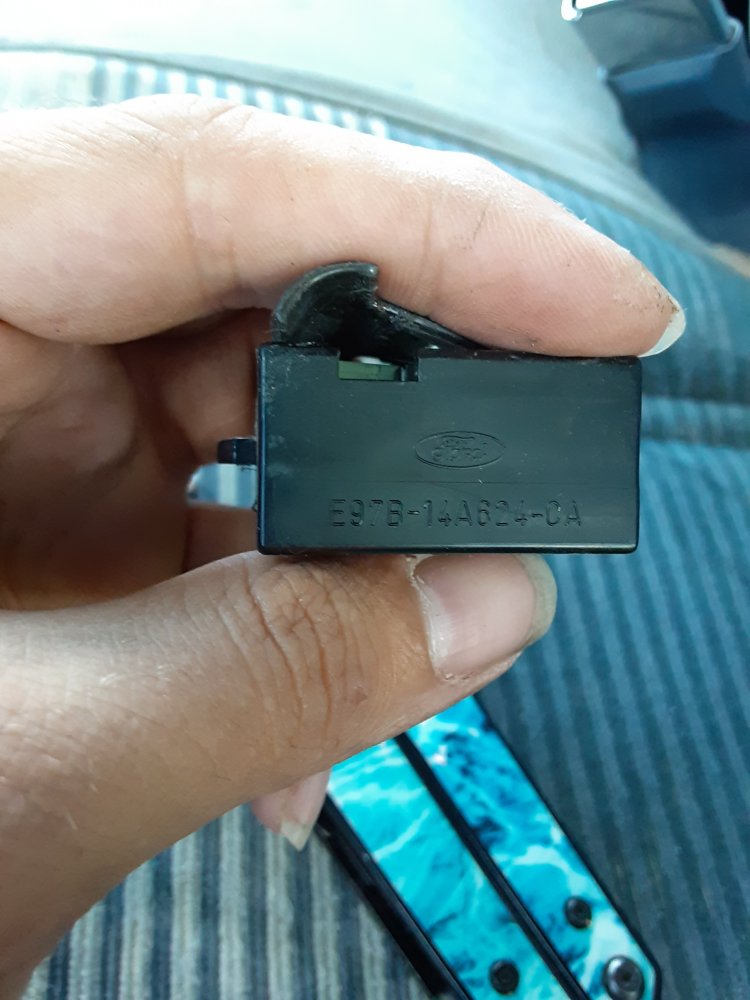

The only identification is the Part Number: Ford E97B-14A624-CA
Is there anyone who is familiar with Ford Part Numbers and tell me what this goes to?

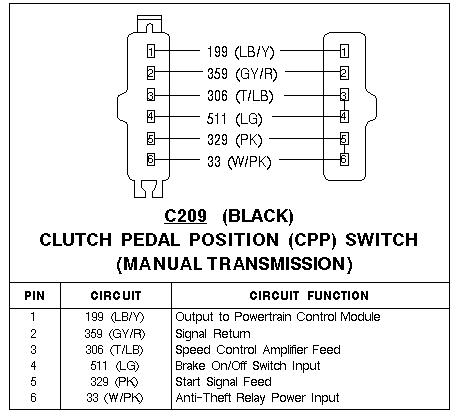

From a quick search, sounds like it might be where a factory jumper is installed on automatic trucks to bypass the clutch safety interlock.

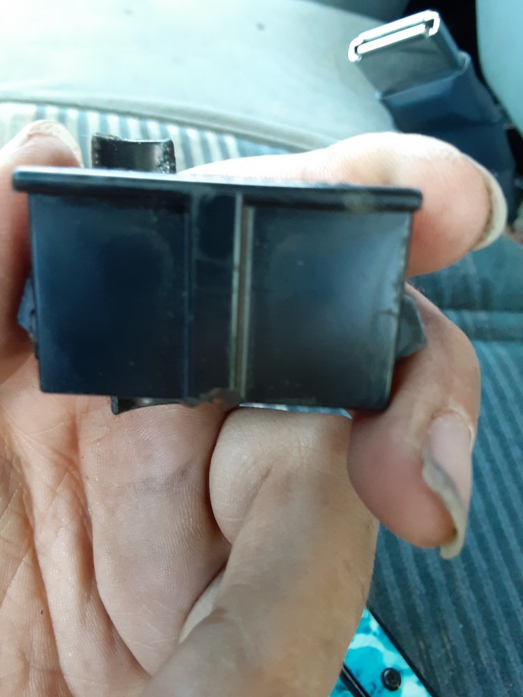

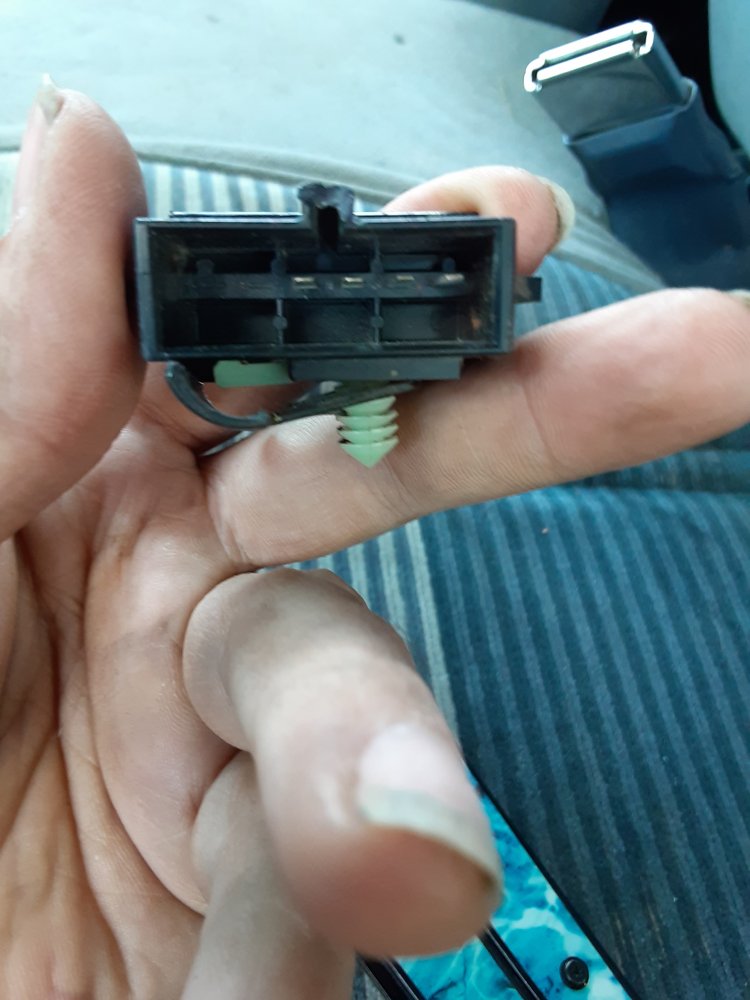

I've attached pictures of the unit and the picture I found on Google that somewhat resembles it.
I also attached a picture of the wire that looks burnt/broke to me.
