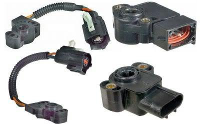

so basically my tps bit the dust and i can’t find a replacement.
34444
everything i can find online looks like the ones on the left but my truck has one like the ones on the left. can i put a new conector in the wiring harness? I can not locate this part anywhere online or in stores. Any advice?

Walker #200-1018 is the correct part.
Why is it not listed for our trucks? I do not know.
It fits T-birds, Merkur XR4-Ti, some others...2.3 powered, naturally. 1988 is a frustrating year.
