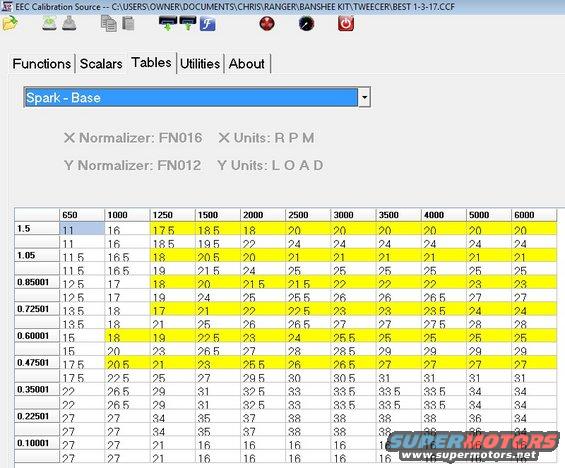

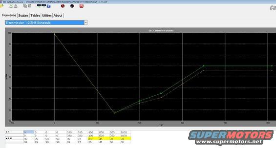

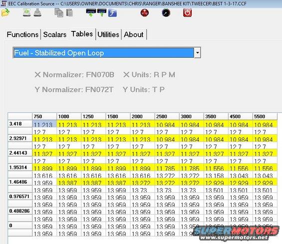

Thought I would share a few things you can tune with a Tweecer. In this case more fuel + more air(boost)= more power. I also thought it might be interesting to you to see what stock open loop fuel is.
Timing comparison:
1-2 shift schedule:
