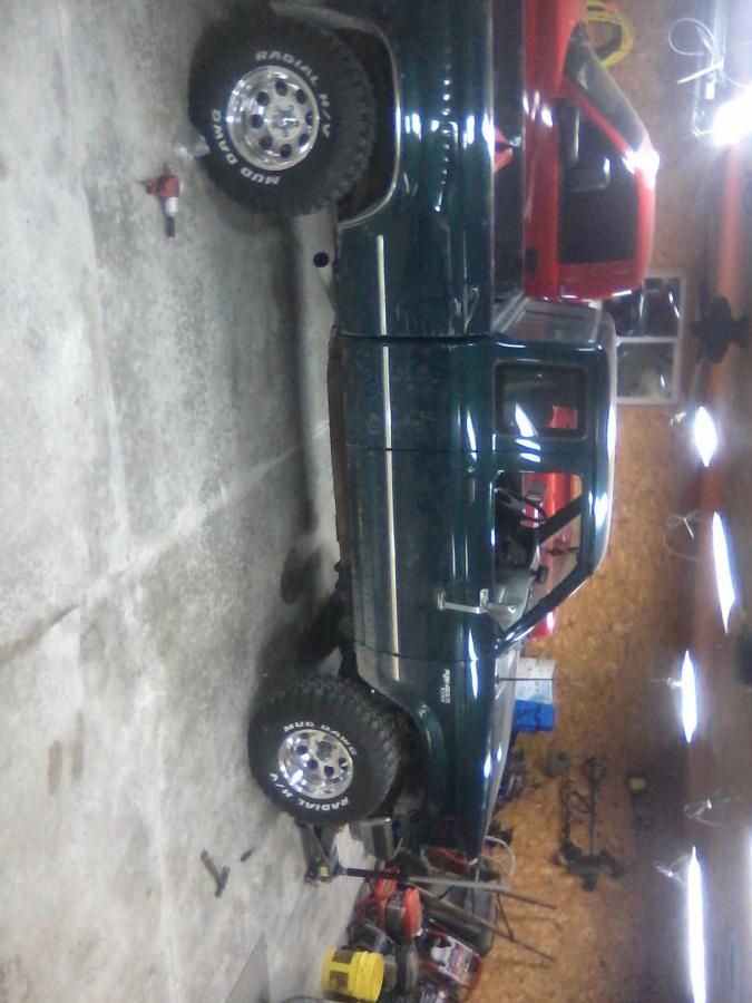

I have a 1991 ford ranger extended cab 4x4 with a 4.0 (removed and replaced with a Kubota Diesel) im needing some advice though. I just bought some 15x8 wheels with 33 12.50's (got a good deal on CL) My truck currently has a 3 inch body lift. I like how high it sits but clearly I have rubbing problems..... I don't mind a little rub but this is way to much, when these tires wear out im going back to 34 10.50's so I don't wanna make it to tall. any advice and input appreciated. post pictures as well! Thanks!
Here's the truck

If your planning to advertise selling the kits here on TRS, you will need to become a vendor. As for the lift, you can get by with extended shackles out back (the Chevy drop shackles at any auto parts store) and up front you can get a 2" lift coil...

You may have to go as far as 31's. Have you thought about fender trimming?
SVT
I got 31 10.50 under there pretty easy, but ya I have.... not sure im going to be very good at it though.
