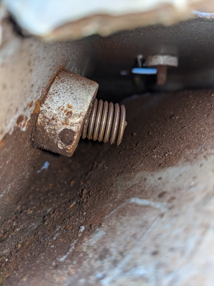

Thanks for all the info, folks. I didn't realize the size of the torx head dictates the diameter and thread pitch of the bolt, although that makes sense.
The shop matched the heli coil to the original spec, it accepts the original bolt, however the coil looks like it has wormed its way through most of the nut, and it is now only engaged with a few threads.
I'll have them check that, but I've attached some pics.

They didn't install that correctly. They were supposed to use a hammer and punch and remove that part that is bent across the hole at the bottom. (The drive tang) have them redo it so you can use the threads.

X2...that is a botch job of a helicoil insert. You may be able to salvage it though. from the bottom where the piece of wire is across the thread, try and screw it back up to where it sits flush, and then punch out the horizontal piece of wire.
Looks like the helicoil threads are already rusting....coat the new bolt with a bit of anti seize.
If you go the longer bolt and nut route, make sure there is at least 2 threads showing through the nut for proper thread engagement. Most bolts have a bit of a taper to the end of the bolt for easier starting. So, full thread engagement doesn’t happen until about two threads in.

X2, Looking at the pic's a longer bolt/washers/nut would be my first choice. A 12 mm bolt is almost 1/2 inch in diameter (12 1/2 mm is half inch) so using a 3/8 or even 7/16 inch grade 5 bolt/washers/nut would be a simple 10 minute repair job. In fact, since the original hole/threads were enlarged, I'm willing to bet that a simple 1/2 inch bolt would work if you removed the helicoil.

I knew it! Thanks for the info. Makes sense you'd need to remove the drive tang before installing the nut.
Removing the helicoil and going direct to the new threads has occurred to me as well. Certainly seems like the simplest approach. The shop didn't charge much for the helicoil.
That's probably a combination of Liquid Wrench and rust from one of the other bolts I worked through there.
Long enough 1/2 inch grade 5 bolt, 2 washers, nylock nut shouldn't run more than a few bucks at your local Lowes or Home Depot.
The threads you tap for helicoil installation are weird. They do NOT conform to normal bolts.
