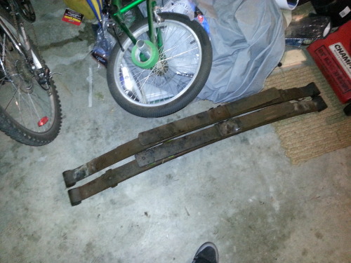

I want to run 31's, so I've ordered some 2" coil spacers for the front. I also bought some used leaf springs for the rear out of a 93 4x4. Will these lift the rear at all? The have 1 more leaf than the ones that are on my truck right now. But I'm not sure about the springs, they could also be from an explorer as they were just sitting in this guy's yard (got em $10 for the pair), I'm not sure.

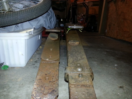

Here's some pics of the springs, they're kinda saggy but so are the ones in my truck, I figure having an extra leaf is better though.

Well, you should be able to run 31's without a lift, any higher and yes. I'm not sure about those springs, if they are saggy and the same as the ones on your truck right now what's the point in swapping them? Personally I wouldn't trust something sitting in a yard rotting away.
I should rephrase that, they were on his 93 4x4 but I'm not sure if they were the stock springs on his truck or if he got them from an explorer (since he had an explorer axle). They weren't sitting for too long, so they should be fine... they're in better condition than mine anyway. I just want to know if they'd lift my truck at all, and they are better since they have an extra leaf. My truck's leaf springs have 2 leafs + 1 helper and these have 3 leafs + 1 helper.

Ah, mines an 07 and sits much taller. I'm no expert on leaf springs but isn't how much they are bent depends on how high the lift, or just measure the width of the spring and thats how much higher it will sit? If so just try and compare them to the ones you have on now.
Yeah, that's the thing, I can't tell for sure without taking the old ones off. I'll probably just order the 2.5" lift shocks and I'll get the Belltech shackles if the new leafs are the same/not much different. Would be nice to get some other opinions though, regarding the shocks: should I cancel the stock replacement shocks and go with the 2.5" lift shocks?
So those leafs are junk. I coated them with EZ Liner, made em look real nice then I realized that they were 2 different kinds of springs! Yeah they had the same amount of leafs and they were roughly the same size, but they had different part numbers and the one that sat lower seemed to be softer. Plus, I accidentally knocked the stiffer one over and the middle leaf cracked. Good thing I didn't put them in my truck, they're garbage now.
