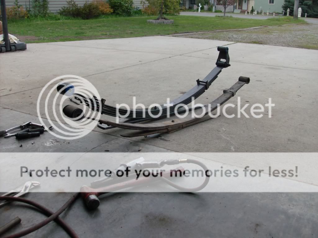

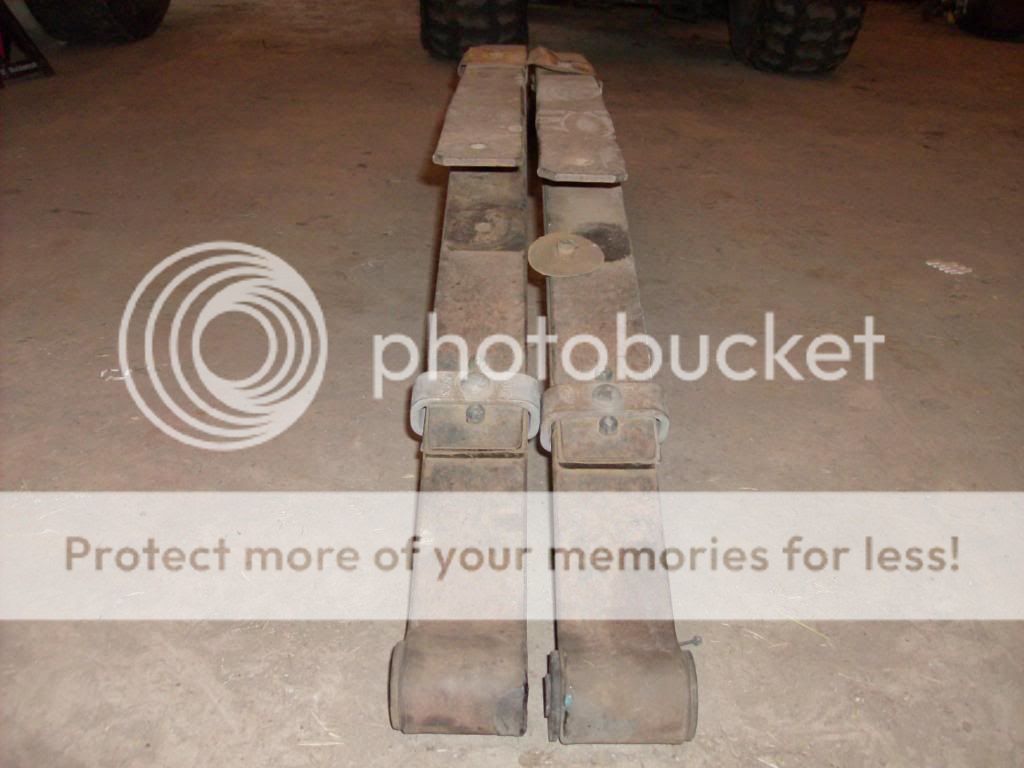

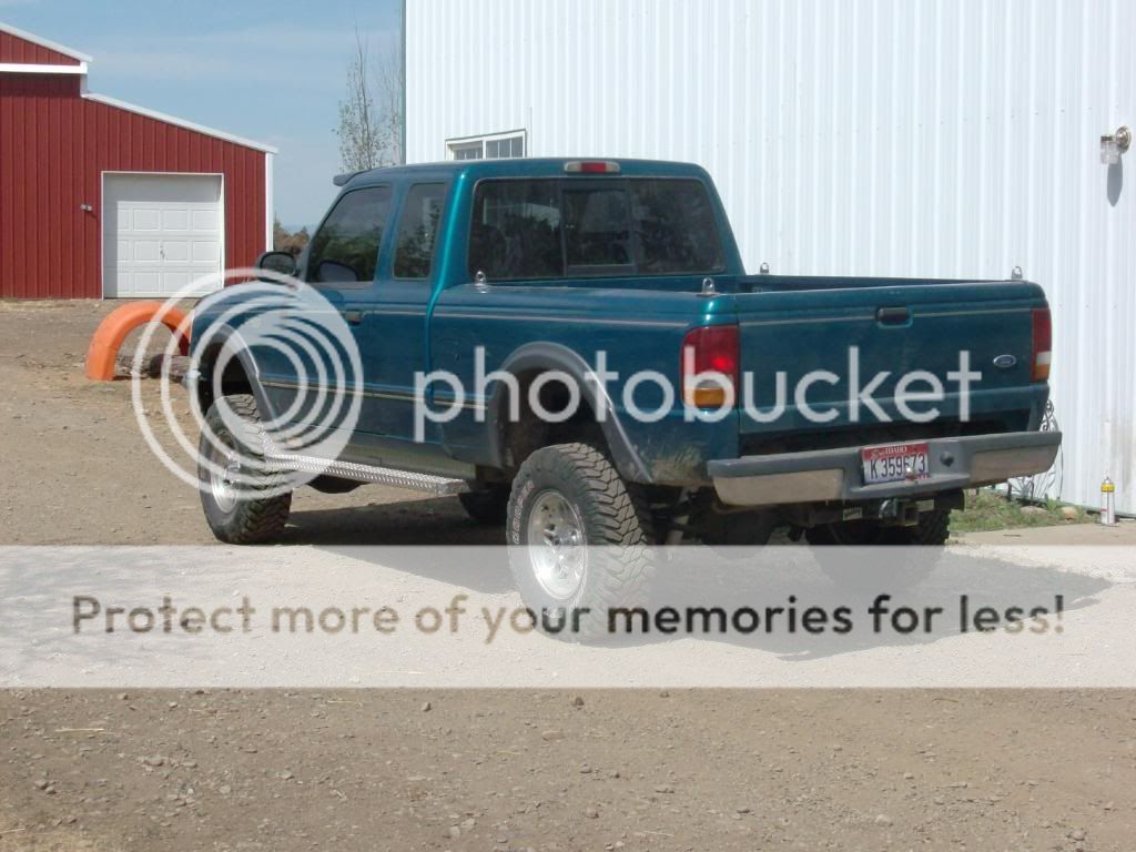

Well I fixed the problem guys!! Took me awhile to get around to posting it up but the problem is solved. The left rear spring was bent and weakened. When I would accelerate or decelerate it would flex more than the right spring, allowing the axle to shift, hence the "torque steer". Solved the problem by installing new tough country springs when I lifted the truck. I did a 4" suspension lift, 2" body lift, and replaced every single bushing on the truck at the same time. It handles so much better now. Here are some pictures:
Before:
After:
During:
Bent left rear leaf spring can be seen on the right. It's noticeably easier to compress than the right spring and sits lower when uncompressed. Clearly the culprit of the torque steer symptoms!
Compare the new and old springs. Feels like I'm driving a F350 with the new springs. They have twice as many leaves.
