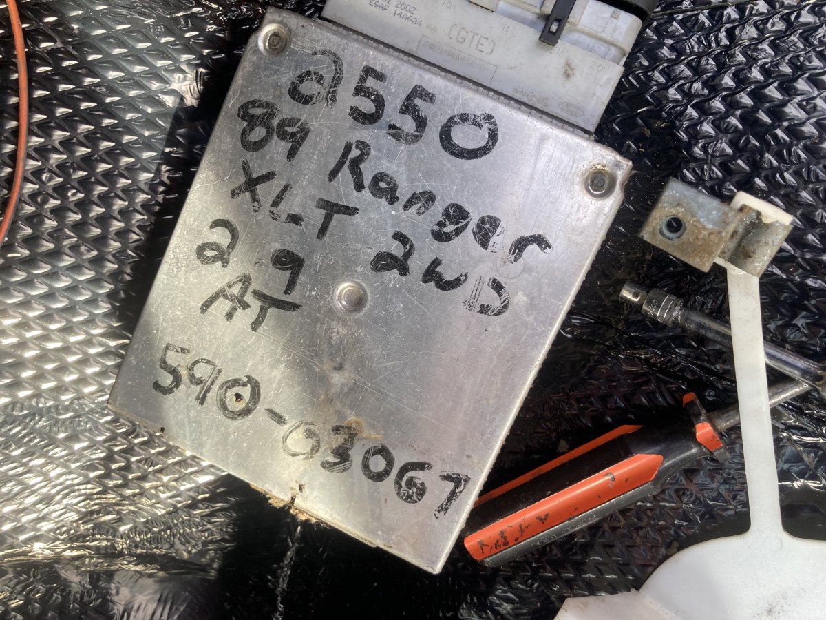

I moved the computer / brain from under passenger footwell so as to do some bodywork behind it and on the back I was surprised to see a different truck model written on it.
Mine is a 1989 2.9 4x4 Automatic..
Not a 2WD
Anything to even consider here or are they all just the same and cross compatible?

I have doubts that your ECM is actually what someone wrote on it with a Sharpie. I did a search for the ECM model E9AF14A624AA that is printed on the connector of your ECM, and I couldn't find a single Ranger associated with that #. Looking at the listings at Rock Auto, every '89 Ranger ECM is either a E9TF12A650** or E9TZ12A650** (the asterisks are 2 letters that designate which version is applicable for your Ranger of that year model).

Need to see top paper label.
Have Master list of EECIV/EECV codes here somewhere. Will find.
Code I need is three alpha numerics.
Seen plenty of F*rd where part number is right and strategy is wrong on brain box because someone put wrong brain in wrong F*rd.
I dont think GTE is 2.9 ranger code, but need to see both sides of your box connecter to know. Might be.
8DT and a few others are manual. Autos are band camp, so don't know off top of head.
Tried to upload spreadsheet, but site won't allow
1989 to1992 according to Cardone. Here is a factory 1990 2.9 auto 4 wheel drive. Removed when I converted to 4 speed and put a new one in for manual. F0TF-12A650-BGA
