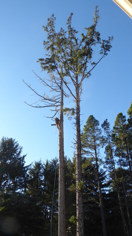

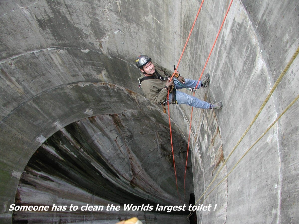

I used to be SPRAT certified and did high-angle inspections of dams, penstocks, etc; my son does arborist work. What you should look for is a low-stretch static line for working or for tensioned loads such as forcing a tree/branch to fall a certain way. If you are climbing structures (not rock climbing) and using a full body harness you need a dynamic line as your backup for belay that will take shock loading and soften the impact if you fall. There are so many newer ascend/descend devices now it's amazing. If you are ascending and working at heights like tree work you need a locking type device like a GriGri or shunt so you can release the rope and use your hands. To me tree work is the most dangerous type of climbing, nothing like a spinning chain saw and falling branches to wake you up.
