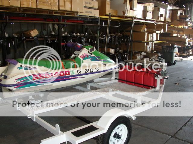

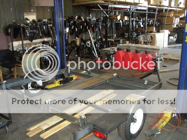

Build it. Me and my pops built a trailer for our two seadoo's. It was alot of fun, plus it was a hell of a lot cheaper then buying one. $600 to build and $2500 to buy.
We just went to the Seadoo shop and took pics of their trailers and built it from the pics and took dimension from our seadoos.

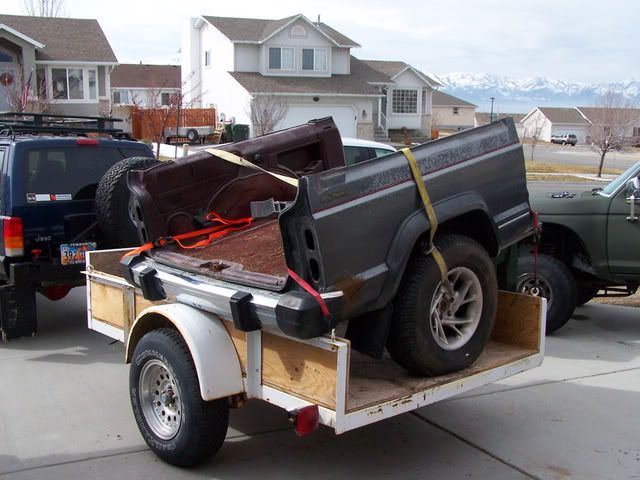

My friends usually use pickup box trailers for storing motors and parts in since most of them don't have permanent storage anywhere. I guess it works but a 7' Ranger trailer gets a little squirrely at 60MPH loaded down with three 351W motors and other assorted parts.
The axle is centered, it would be tough to get the loading right with that much weight on that small of a trailer.
That said, I have the beginings of a 7' Ranger box trailer. Just gotta finish taking the fuel system out of it, bend the frame rails together, put a hitch on it and get the lights to work.
