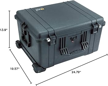

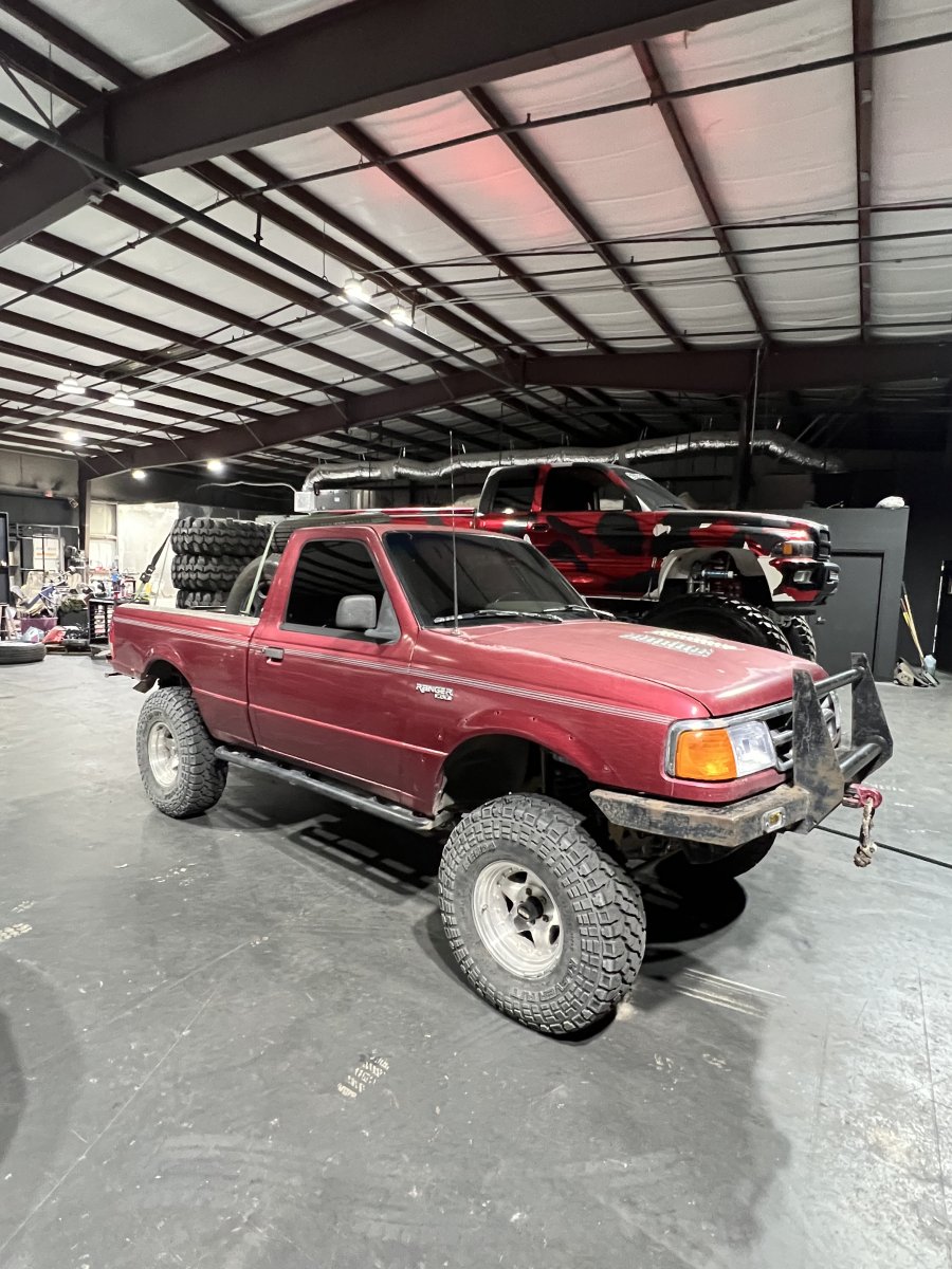

I’m some what refocusing how I outfit my 94 RCSB to be much lighter and setup for solo exploration. In doing so I am ditching the traditional aluminum tool box that sits over the bed rails and switching to 2-3 Pelican 1620 cases.
One will be setup with nothing but recovery gear, soft shackles, kinetic ropes, winch extensions, shovel, tree savers, all that good stuff. It will be setup to be transferred from my ranger to other vehicles depending on what I’m doing.
The second will be generic tools and fluids. An off-road jack, tire change stuff, socket set, shop towels, oils, coolant, stuff that can also be useful for me to grab for any of the vehicles I have depending on the adventure ahead.
The third will be vehicle specific parts and tools for stuff that is fixable on the side of a trail or possibly the middle of the trail and this is kinda where I need help. What would you all bring in this box if it was yours?

This is all for my 94, 4.0, 5speed truck, I can provide more details if you’d like.

I think a new parameter to put in this to keep the scope from getting out of hand is that it must fit inside the 1620 which is around 12x16x20”.

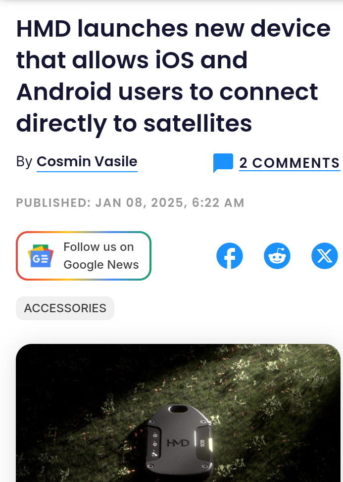

You might consider one of these if you're going out of cell range. Kind of expensive but worth peace of mind.
Link to info on the one pictured.
https://www.phonearena.com/news/hmd-offgrid-device-satellite-communication_id166362View attachment 122508
New iPhones already have satellite SOS capabilities so I’m not sure what this does for you unless it gives you more sat phone abilities rather than just sending a broadcast for help and limited text capabilities.

For cell service I’m lucky to have a cool work phone that has some sort of magic that allows it to literally always have service, even during disasters where towers are down, or the networks are overwhelmed.
