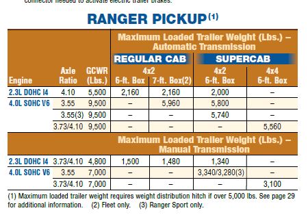

Tow ratings 2011 Ranger
So basically with a Supercab and 2.3 and an auto transmission, max trailer weight 2,000 lbs, trailer no taller than the hood of the truck
yeah i was thinking 2k was pretty standard for 4 banger trucks pretty much the whole ranger run.

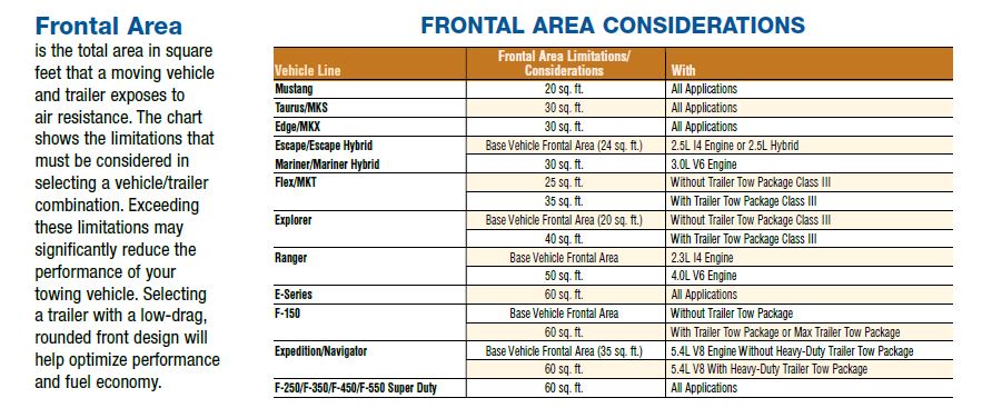

Frontal area:
Trailer no higher than roof of the truck not the hood ;) And its a soft limit - performance is degraded.
