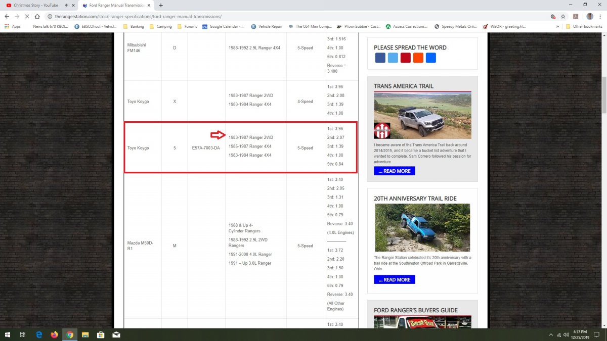

Tell ford that because the door sticker and the ranger station both show the TK5 being in my Ranger...so what's correct? Haven't crawled under it to see but going by the door sticker code, the Vin decoder, and the ranger station's own door code deciphering it says the TK5 is in my Ranger WTH LOL. Not that it matters none of them are good transmissions anyhow, they all fall into the same garbage category as the A4LD LOL.
So TRS's tech section is incorrect? Door sticker incorrect?
