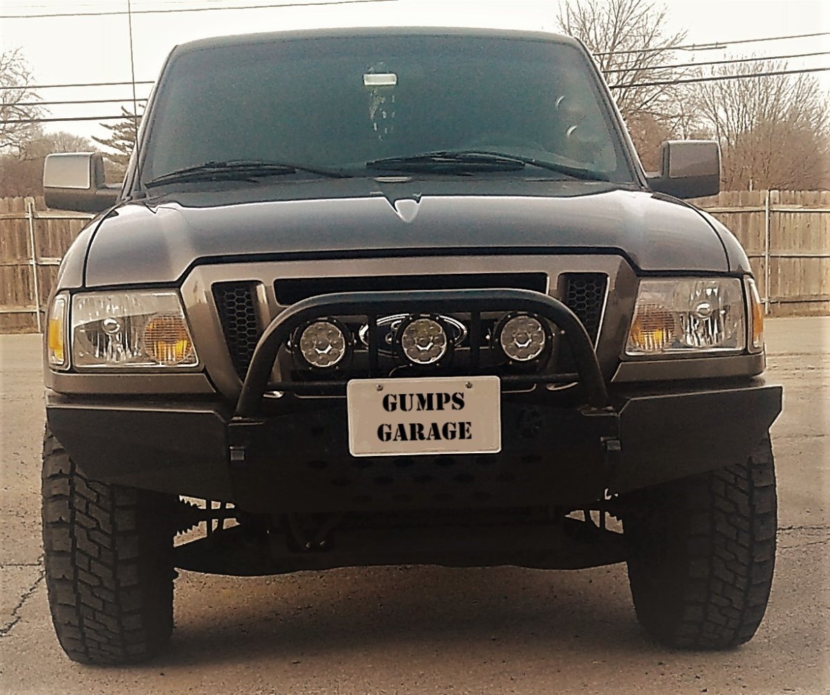

This is my truck on 32 inch tires still at factory torsion bar settings... my axles are straight... and I've only had it rub once lightly. But I don't hard core off road. Your results may be different. I would like to see where your truck is currently at... you say maxed torsion bar didn't change much.
