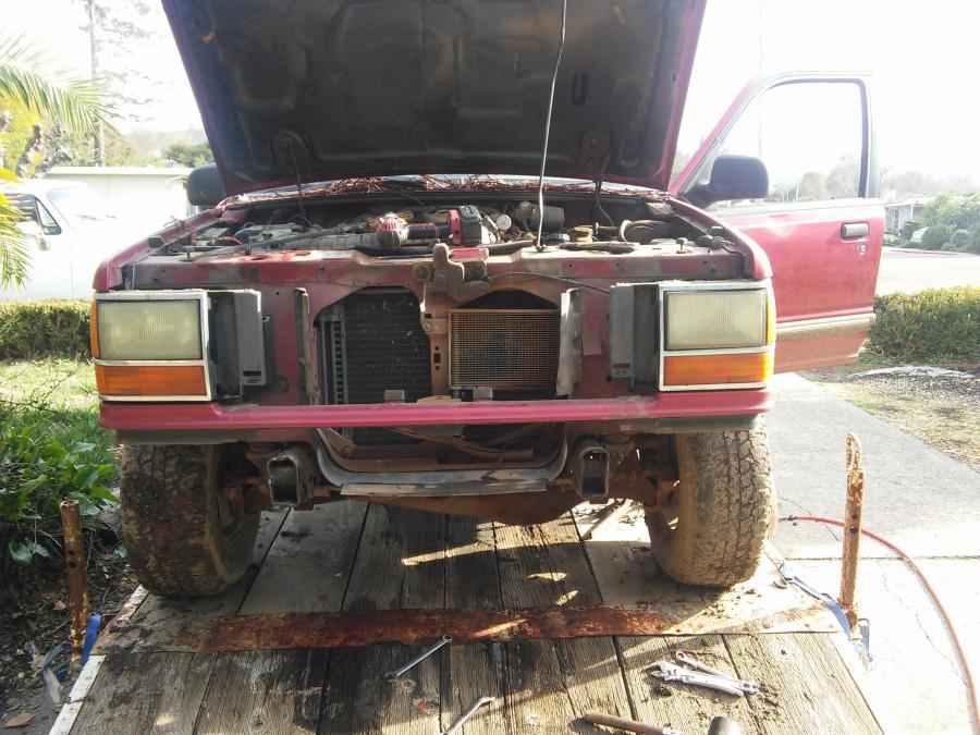

Nice truck. OK I think I get it. Today I towed it home and started at the front bumper. On old (like me) cars you could just take out the two big bolts going through the frame and radiator support, and undo the fenders back at the cowl and lift the whole enchilada off. So now the inner fenders are spot welded to the cowl and the radiator support? I'm thinking maybe just cut two feet out of the radiator support at the top to assist getting the engine (and maybe trans) out and sending the fenders to the scrap yard with the rest. Sound like a plan?

Yeah, the full size you can remove the whole front clip. On these smaller trucks they are spot welded....it sucks.
Most times there isn't much call for the rad support, but it's worth a shot with an ad. Put an ad on this site too. And cutting 2 feet out of the top is how I was able to pull the motor/trans/t-case all at once out of a 91 explorer.
