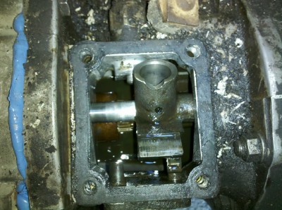

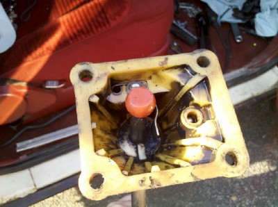

Just purchased an 89 Bronco II, that's had the TK5 transmission supposedly rebuilt. The shifter is extremely loose, yet when I take it off, the ball and shifter appear to be all there. The issue is I cannot get it to go into gear, most of the time, like it's not lined up, and sometimes it will go right in. Sometimes when the clutch is depressed it's still sort of in gear, and sometimes its fine. When the engine is off, it will go right in, but sometimes when its running, it won't go in. The part in the trans that the ball of the shifter sits in seems very loose as well, it moves all over the place and rotates very freely. I looked at a schematic at a ford dealer and it showed a bolt in this part, but I think it's missing that bolt. Would that tighten this thing up without replacing the shifter? I will try to post some pics to hopefully show what I'm talking about. It's very frustrating driving this thing.
Thanks in advance.

I was just purking and noticed your post..
This may not help you but a couple of things come to mind. How new is this car to you?...Since a TK-5 never came in an 89..perhaps the fellow you bought it form may have an answer to what may be happening inside the trans?...
It's been a while since i had a shifter off of a tk-5 and i can' t remember exactly what they look like vs: a tk-4..i know ONE of them has a detent spring in the tower but i can't remember which...but sound like there may be some internal issues anyway..
Can you take the car back to who sold it to you to get some answers?...probably not...but since someone obviously change it over from what it originally came with they may have some ideas....
anyway good luck

Yeah, the guy I bought it from did a swap to this transmission. He just said it was because the shifter was plastic and messed up, but after I took it off it looks normal to me. I just got a tk4 shifter, which is the metal one, and it has a spring in the tower, and the tk5 plastic one does not have a spring. Not sure why one has one and the other doesn't, if they can be swapped. The previous owner said he rebuilt the trans completely, and it went back together the way it came apart, so either something broke since then, or it was broke prior to him "rebuilding it".
I'm about to install the new shifter, so hopefully this will help with the troubleshooting. If it's still shifting bad, I'll know it wasn't the shifter.
I really would like to find out if there is a bolt that holds the receiver part in the transmission to the shaft it rides on.
Update. I installed the tk4 shifter, which lined up with the bolts perfectly, so no drilling, and it tightened up the shifter like a normal shifter. However, it won't go into ANY gear now when the vehicle is running, but shifts fine when it's not running, so now I'm wondering if it's the clutch not disengaging fully. I usually put it in gear and start it, and then while I'm driving it will shift, harder in first and second, but easier in third through fifth. Grinds when I try to put it in reverse at a stand still. Could it be that the guy used a wrong master cylinder for this set up and it doesn't push the slave far enough? The pedal does seem a bit weird, but again, sometimes it worked, and sometimes it didn't so maybe something is hanging up? I live in an apartment so I can't just take this transmission out in the parking lot to check.
..... oh, and if anyone knows, do I really need that spring inside the metal shifter cover of the tk4? It seems to shift fine without it.
if i remember right...
the spring has more to do with the reverse gate?...not sure..i know the tk-4 is desired for replacement cuz it's metal...
