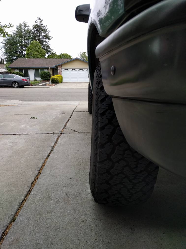

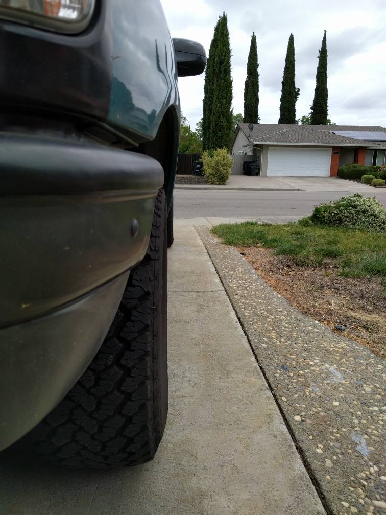

Maybe this is the issue? I noticed that the pinch bolt wasn't tightened after the alignment. Look at the difference in camber side to side. Would that cause a noise only while turning left? I'd better go back to big o tires and demand they fix it... It's hard to find people that do things right anymore...
Sent from my Nexus 6P using Tapatalk
It was the alignment. The camber was way off, which probably threw out the toe. No more noise now. Thanks for the help!
