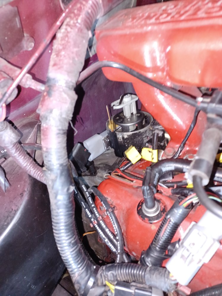

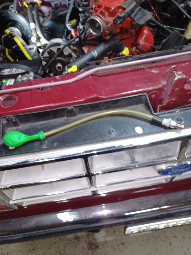

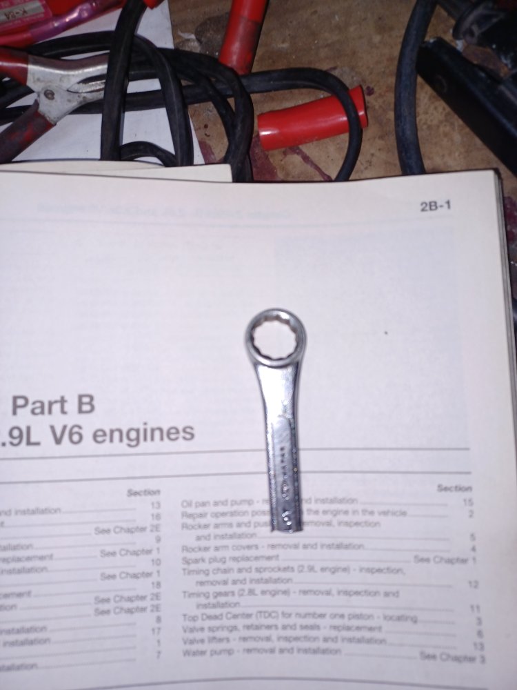

So for all you dyi guys here are a few tips I use to make job a little easier. Especially, if like me, you work alone with no help. First take a 1/2 or 13mm boxend wrench and cut down long enough to turn lock down bolt on distributor without hitting firewall. Saves a lot of cussing. Second I took a old spark plug, removed the porcelain, hollowed it out and inserted a piece of hose that fit tight into the hollowed out plug. Then I took a piece of tubing and inserted into the hose for a tight fit. Stuck a Ballon on end and it worked great for finding TDC on compression stroke #1piston. Lastly Givin the God awful place they put distributor on 2.9 engine it is hard to line up rotor with #1 on cap. What I do is tape a piece straw off a broom stick to the distributor housing lined up with # 1 on cap before installing into motor. Make sure it sticks up high enough to hit the height of the pointer on rotor. Am going to try to add pics.

Or you could buy a distributor wrench.
