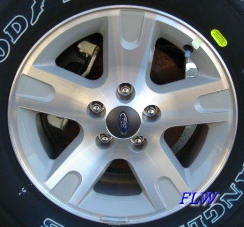

any pics of these wheels that have been POLISHED?
I plan to remove any curb rash & paint all receased area's the same color as the truck. Subaru Rally Blue Pearl & then polish the remaining wheel area. Not sure if the painted area's should be done prior to polishing or after polish. I will be coating entire wheels after polishing with Duplicolor clear Wheel Coating. And painting center cap Silver wheel paint. I have all black powder coated lug nuts
Can any one do a photo shop of the wheel with the area's between spokes,U shaped ares on spokes & lug nut holes in Metallic blue & center cap silver with remaining wheel Polished & with black lug nuts
Another thought is to coat entire wheel with reflective clear coat then Duplicolor clear Wheel Coating.

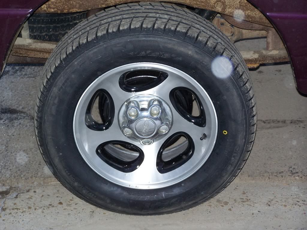

I used Dupli-Color wheel coating on mine, did the inside of the holes flat black, and of course, when I cleared over them, it turned to gloss.
http://www.duplicolor.com/products/wheelCoating/
I didn't polish them, but I had buffed them with a fine grade 3M pad chucked in a 1/2" hand drill, which gave more of a brushed finish.
They were spotlessly prepped, clean and dry when I sprayed them, but the finish eventually chipped off, and after 4 years they looked like crap again. Corrosion under the clearcoat where rocks had dinged the finish, and the black was coming off in the holes here and there, again, from gravel roads.
This is when I first did them:
my wheels dont have tires on them so I can take my time & do a very thorough job on them. I like the way your wheels turned out to bad they didnt stay that way.

Thanks for showing the photoshop wheel Now I can better imagine mine in Blue metallic with the wheel being polished
If and when you do yours do a write up on it with pics if you don't mind then I might get off my butt and paint mine black like the pic...wish you success!
