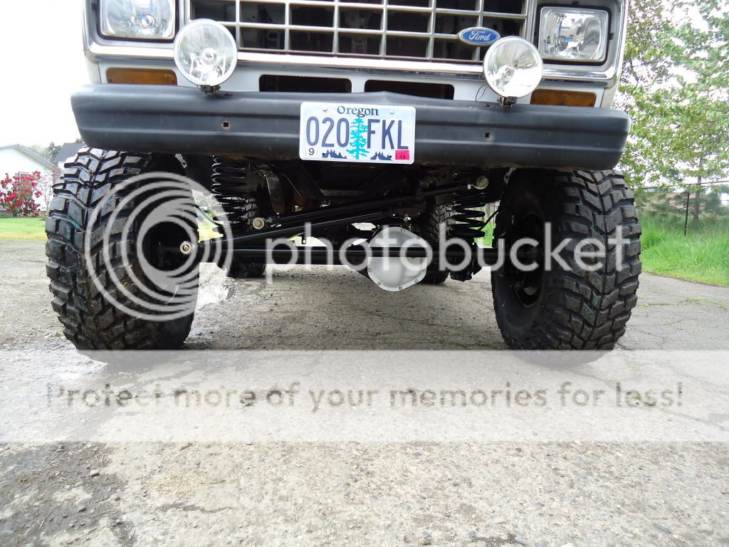

Ever since I've completed my SAS i've had terrible steering. Its all over the road and its unpredictable. Its not bump steer but I can't figure out whats causing it. I have not paid to get it aligned, I just aligned it myself in my driveway with about 1/8-1/4" toe in. I was using 7* "c" bushings but replaced them with 2* and nothing changed. I checked tire pressure and dialed it in using chalk on the tires. I'm running 26psi in all the tires. Its very hard to explain the symptoms...but its just hard to keep it in a straight line. Any idea's?
Post up a pic of your setup. Is your linkage and tracbar both parallel and close to the same length?

I'll check the toe again. The trackbar/steering arm are the same angle and length. I'm going to shorten the track bar because it sticks out of the driverside frame too far.
This is the best pic I have at the moment...

knuckles look like the caster is too light.
the angles are good but the offset relationship is not always ideal for steering feel and a big reason i prefer over rail steering boxes.
