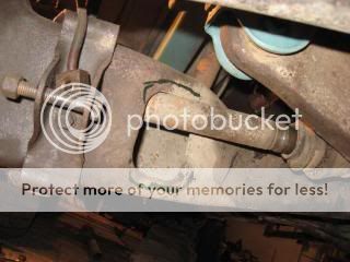

But those are for a 4WD, not a 2WD. The 4WD beams will not bolt onto a first gen 2wd without swapping up to newer model beams.
On those 4WD bars the bar bolts to the frame foward of the front axle, and the end links go to these brackets (one with the bolt in it on left side of pic) on the axle. 89-97 2WDs had the same brackets on the axles.
Every first gen 2WD Ranger I've ever seen has had this "post" in the same location and it isn't removable.
As I said earlier the only way to mount one of those type bars to his Ranger is to also swap out the beams to later model stuff. Considering the cost of that later model stuff he'd probably pay less to just buy an aftermarket bar for the front.
Why not?
"Removable" doesn't usually include things that can only be removed with cutting tools, especially not in the context of this thread. Cut it off you still don't have the threaded bolt hole that bracket bolts to on the front of the axle. The bracket on a 2wd is slightly different that the one on a 4WD and requires that bolt to mount it. I'll try to get a pic tomorrow to show what I mean.
In order to make it work you would have to cut that stud off flush with the front of the axle, bore out the remaining part of the stud in the beam(don't want to think of how hard metal that is), and then run a tap the proper size through hole. For the average home mechanic that process would not be possible. (Before you make a remark about that with your 4bt swap you can't be classified as average). Even if you could do all of that with it still on the truck, you still gotta disassemble half the front end to attach the brackets to the beam.
