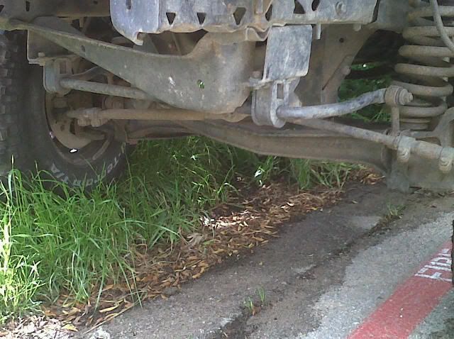

I have a f150 front end right now, but someone told me i can use a 1981 - ? f100 front end and it will widen the wheel base. anyone have any knowledge on the subject? will the beams just swap over and use the same spot for the coils and steering?
Are you sure those are f-150 beams?
As far as 2 wheel drive trucks go... There is almost no benefit in putting 82-96 f-150 beams on a ranger.. The amount of work there is in order to mount them properly is not logical. Everybody says "oh they just bolt right in and my track width will be increased." If this was the case people would be running them left and right.. The beams are not equal in length. The differences in the beam length is not the same as the ranger. Therefore, if you bolted F-150 beams in the ranger mounting points, on tire will be sticking out further then the other. :)
