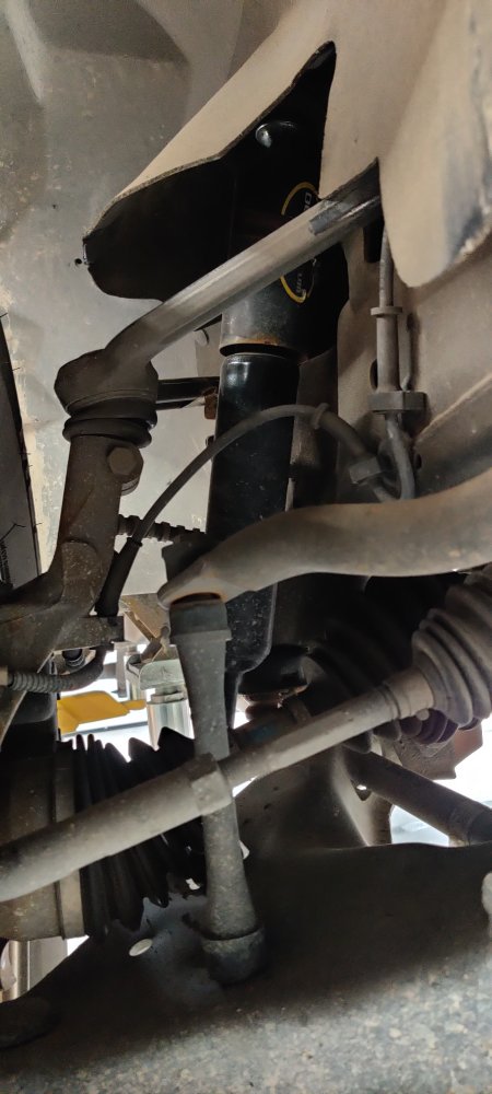

Any advice on replacing the stock front shocks? The Rancho RS55374 appears to be my only option with a raised front, however I've heard from a number of people their quality isn't what it used to be. Or is it better to change something with the front control arms/suspension so I can fit regular type shocks? I read about coil conversions, but all the links were dead.
(Note the clean area where the bump stop is always making contact, and that's just driving around town)

No the shocks (both front and rear) were different for the FX4 than for the regular 4x4 Rangers in 2003. A quick look at RockAuto shows 5 different Motorcraft numbers for the rear shocks including one for the Off Road Package, and 3 different front shocks including 2 different ones for the torsion bar front suspension. And there are options for raised ride height shown as well.
None of the ones I'm seeing (front) other than the Rancho's have both the peg-leg design (to clear the CV shaft) and the raised height.

The ASH1094 is the stock Motorcraft for torsion bar front. The BILSTEIN 24188241 is the torsion bar heavy duty front. Both are the "chicken leg" look and are on RockAuto.

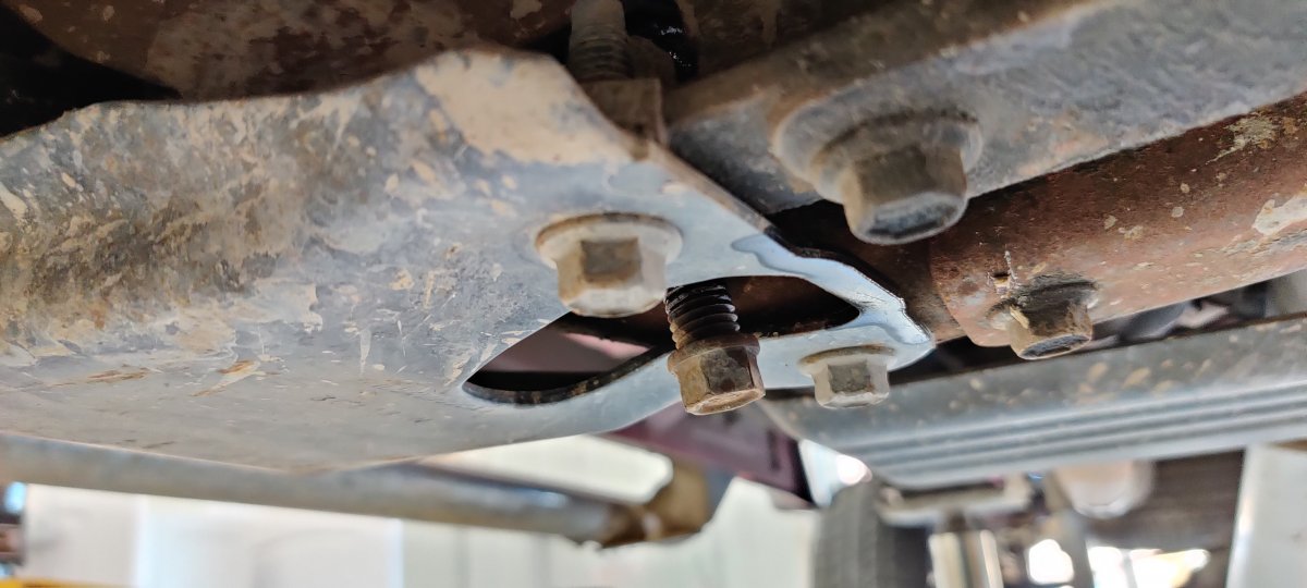

So I pulled off those helpers in the rear and figured I'd try winding up the stock adjusters.
Is it normal for the adjusters to be quite different left to right? The passenger side adjuster is barely turned in with about 1.56" of bolt remaining, while the driver side is cranked in most of the way with about 0.75" of bolt left. If it's not unusual, any idea how many turns are needed? I'm half wondering if I might need a fresh set of torsion rods or a new set of keys. The truck only has 70k on it, so they shouldn't be tired yet.

The torsion adjuster bolts (side to side) almost always vary how much they are turned in. This is courtesy of @gw33gp in another thread (post 2)... it's all about the ride height regardless of where the adjuster bolts end up. This is out of his factory manual for 02... your 03 should be the same.
