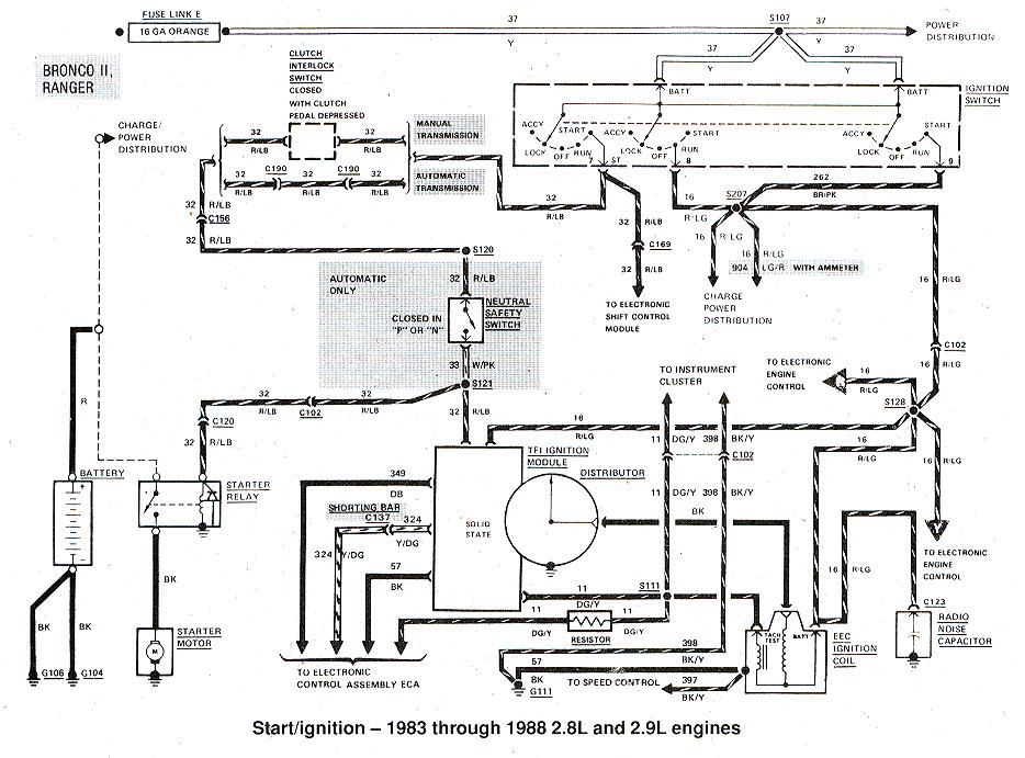

Anyone got a diagram for it? I dont even know what to search for on that....or where to start.
Found this. But it looks like on a manual the wire dead ends after the clutch switch?
It continues on through the box that says "Automatic only" then to splice 121 and out to the starter relay and the box labeled "solid state" Guessing that is the PCM?
So that diagram is showing 2 possible paths in that box. Depending on whether you have a manual or automatic.
I think solid state is reffering to the TFI? This is confusing as hell to me.
