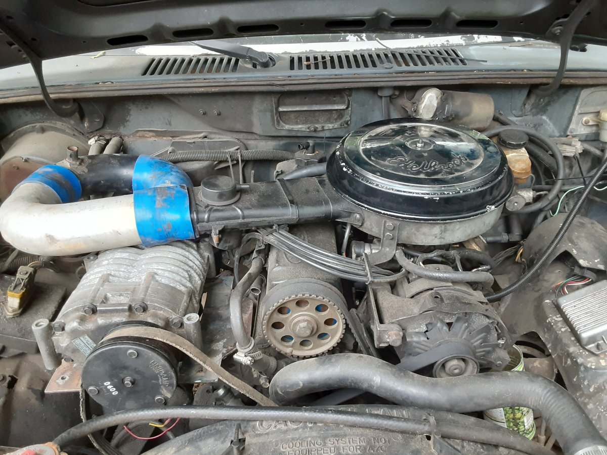

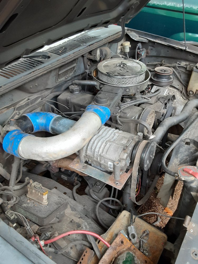

2.0 lima with eaton m62 mocked up today... messing around with this for fun because I have a fresh 2.3 I'm swapping in when this one quits

I'm not sure the single bolt air filter lid will hold any pressure, but the breather would need to be relocated to before the supercharger or you will have oil seal issues...
Lol I know i disconnected it to run to a catch can... either baked bean can or a Mason jar havnt decided! I have a water/meth kit I got in a trade with some 2.3 stuff that I may install!!!
Actually drove it about a mile today.. had the in and out backwards since last car I had on was reverse rotation. Was a little peppier then before still need to change the 3" boost pipe to 2.5" to clear the hood better put on some more clamps run catch can, zip tie some nipples and some kinda bypass valve...
