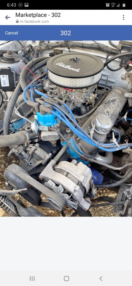

I am really curious what it has for a supercharger to have that intake.
This is a pic before it was pulled without the super. I just got off work so I'll try to get a daytime pic tomorrow

Hopefully you didn't pay for a Supercharged 5.0... because you don't have one.
