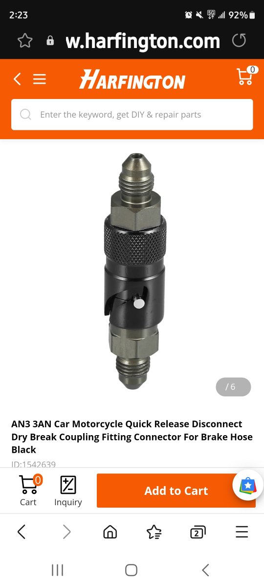

Then a dry break AN-3 quick disconnect like this for the hydraulic line :
This keeps the 'Quick Disconnect' feature for future maintenance or modifications but is waaaaay more professional and not prone to the stupidity of the factory part.
