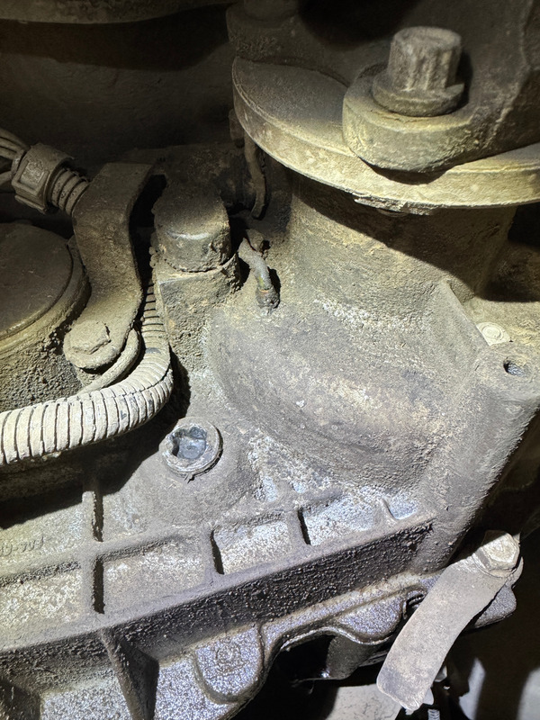

Just going through my new to me Bronco II, and came across an uncooperative fill plug :(
Good thing I didn't drain before checking :)
Any tips on getting this sucker loose?
Thanks
Dissimilar metals corrode together. I would start by soaking it down with penetrant. Tap it a few times with a small ball pien hammer... try to loosen. Repeat...
If you can get a hammer swing in there... Use a cold chisel on the outer face and start tapping fairly hard. Eventually it will start to move.
What a pain in the A**

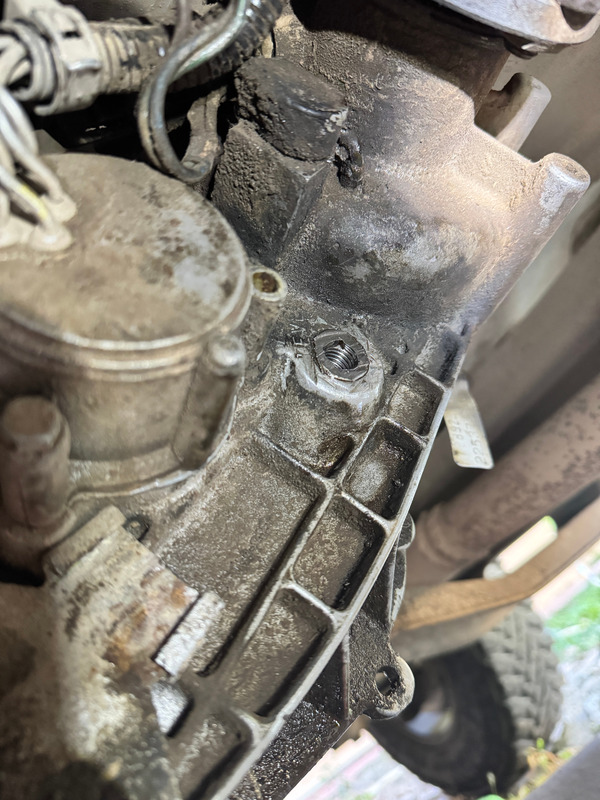

Tried the bolt method, mentioned in the video above.
Fill plug was not letting go, only ended up deforming further.
I ended up drilling a hole, and tried removing the fill plug via an ez-out...no luck.
Since I already had a hole, I taped it and now have a new fill bolt :)
So glad this is done...just in time to cook dinner :P
Nice. There is usually another way.
Might want to file that boss flatter and don't forget a crush washer.
Nice thinking outside the box!
All ready using a crush washer, but good idea on prepping the surface to be more bolt/washer friendly.

I was surprised how stuck the fill plug was...just did not want to budge.
I tried:
Large Steel Bolt, profiled to fit the plug tightly.
Chisel & BFH.
Heat around around the fill-plug.
Vice Grips, unfortunately not enough shoulder to bite onto.
Drilled hole for ez-out.
Didn't want to risk breaking it, but a larger ez-out might have worked (largest I own is around 5/16th).
Even though I wasn't able to get the fill plug out, I'm pleased with the solution.

Just food for thought next time one fights ya, I deal with a lot of old plugs and the regular socket really helps.
Once you start to waller out the hole it goes downhill quick.
