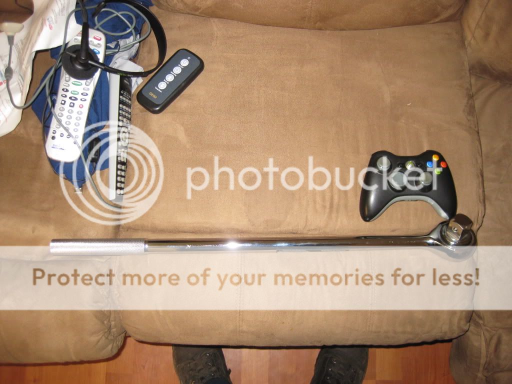

Then the Y-pipe bolts were stuck. I had the longest 1/2 ratchet that Snap-On makes and the shaft was flexing.
So I went out and solved my problem by throwing money at it.
And more ratchet. Did I mention I threw more ratchet at it too?
Hope this helps anyone who runs into the same issue.
(The xbox controller is there for scale. For those who don't know the size of the controller, it's 1" drive.)
