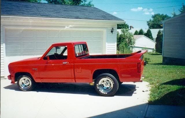

The Engine was out of a 79 Mustang , but bored .30 over with a new crank , Forged Pistons , 63 289 heads with .60 cut , Chevy valves , Ford racing cam dont remember the specs , Hooker Headers , The original set up had a edelbrock 2x4 intake with 2- Carter 750s on it ,, It was tough to run so went back to just one , C6 tranny , 373s out back ,, The Rear was a single track so it would not launch at the track at all ,, it also has a fuel pump problem so I never got it into third , ran 15.00 flat at over 100 mph in second gear , The Rear tires are 29 inches tall ,,, I will load some more pics of it ,
