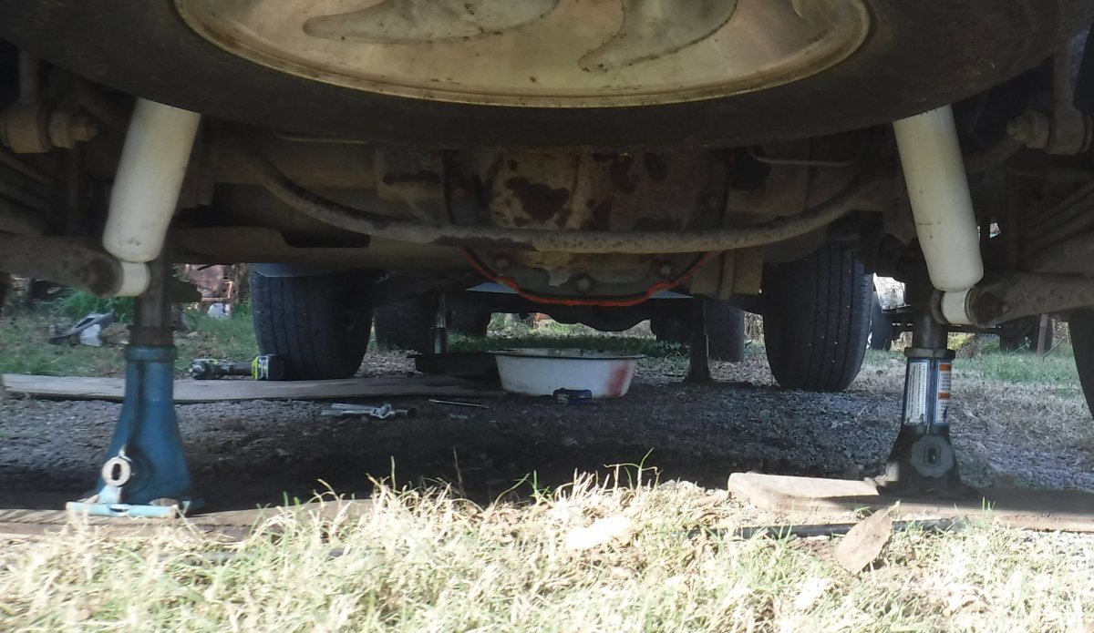

I now use them almost exclusively, Here's where I was working on the transmission a couple weeks ago. The two in front are both from Explorers, one with the car and the other from the wrecking yard($2.50). The two in back are, on right the one from 93 Ranger and blue one on left is probly 50s or 60s something, at a sale ($2).
Please note, they are no replacement for a jackstand, but on this vehicle, in the front there is only one point for lifting/support, and no way to incorporate them together. In the back I could have put one each side on the axles, but was not doing any alterations underneath, just dropping the transmission pan etc., and it was on a flat surface, stable soil, and still had the wheels on it. For carrying with me I carry one jack and one jack stand, and some exterior grade 3/4" plywood squares for a pad.
I've been through so many floor and bottle jacks I can't count, most were decent, some were very good, but they always seem to eventually fail, and I'm not familiar with their repair, so they eventually get trashed or left in a corner somewhere.
Between the two I've come to rely more on the factory jacks, they're easy to tuck away, easy to use, and they don't leak oil ;)

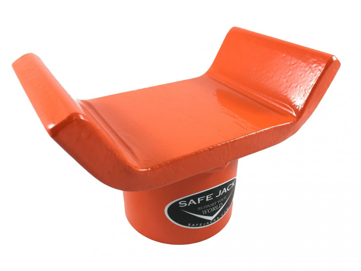

I have these, exclusively for bottle jacks. Orange one is for my 20 ton jack for the motorhome, silver is for the smaller 4/6/8/ ton jacks.
Never have to worry about supporting the truck with a 2 inch jack pad.
Expensive, and only available from Safe Jack.

That's pretty much exactly what I made for mine lol. Took me 15 minutes. Mines painted neon green though cause I kept loosing it in the dirt. :ROFLMAO:
If I had the skills welding, I would have made it. Welding shops wanted almost as much to make one as it cost me from Safe Jack.
Besides, it's lifting 16,000 lbs of motor home and I did not want to take chances.
