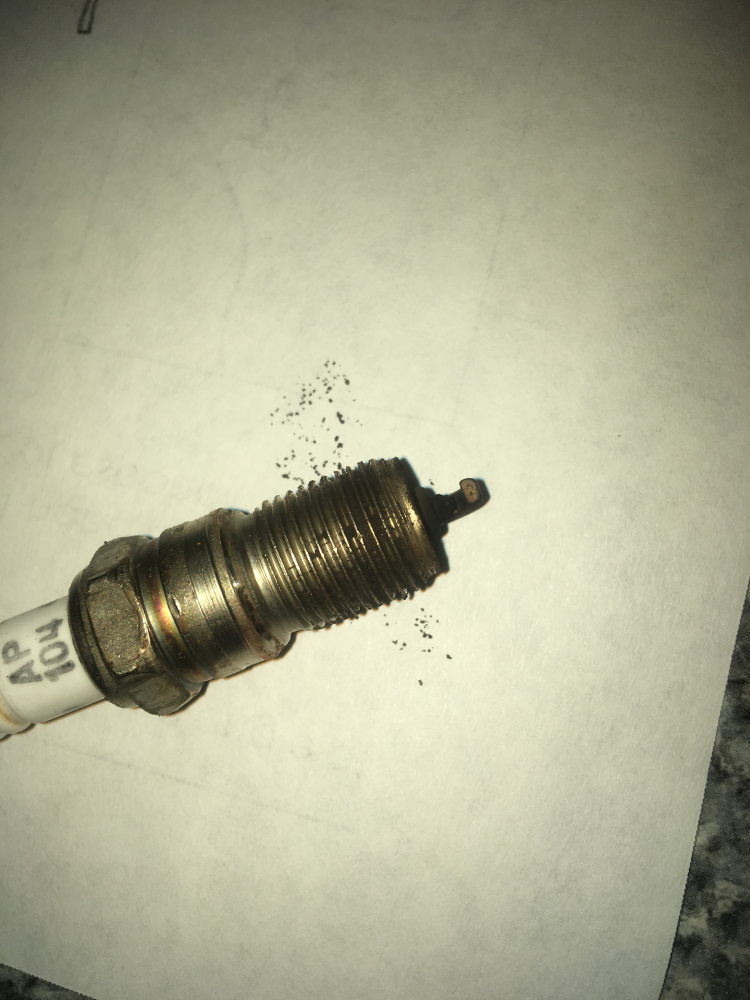

  3. Spark plugs, all 8 old ones were consistently a bit sooty but didn’t look terrible to me.
