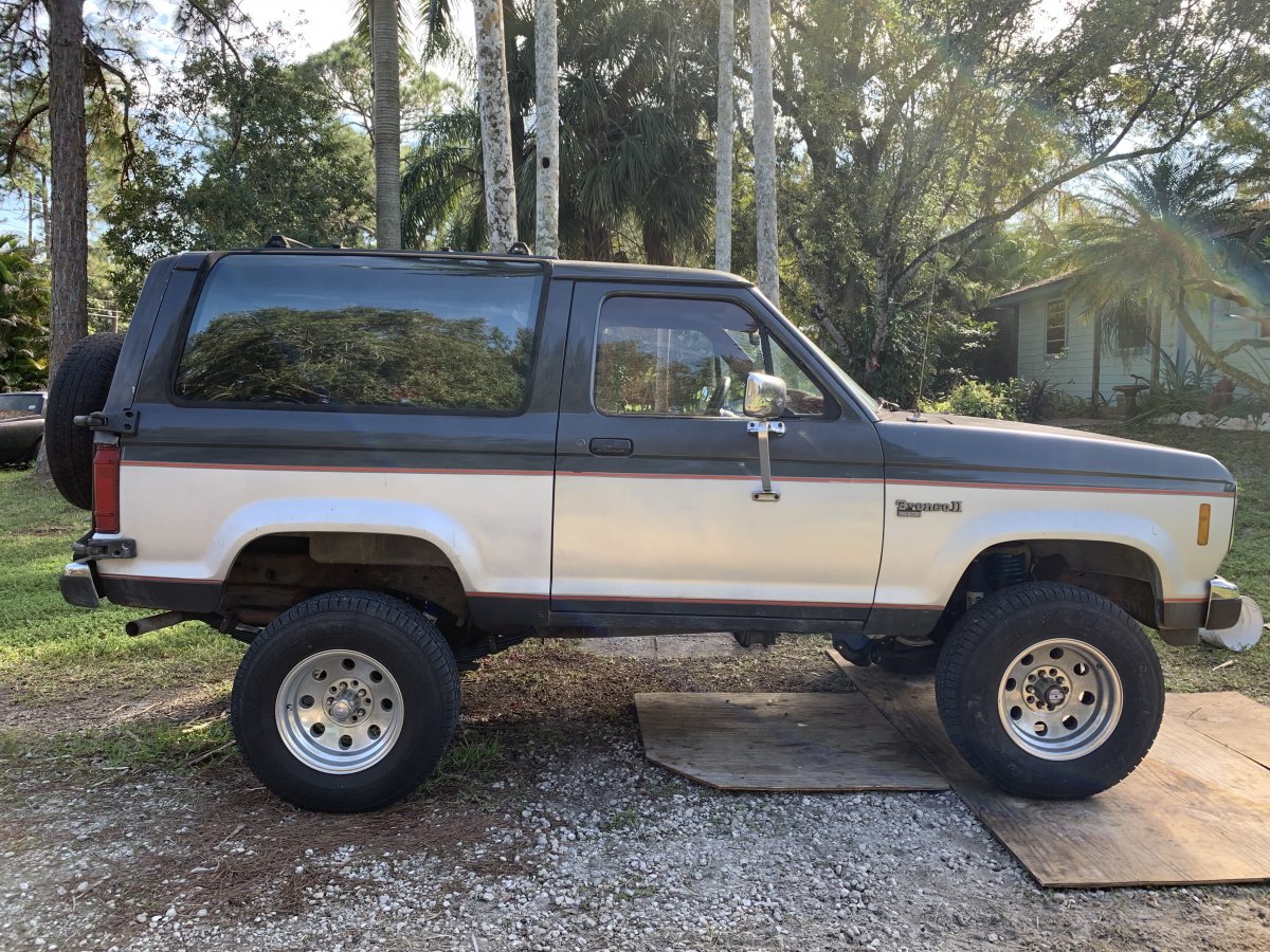

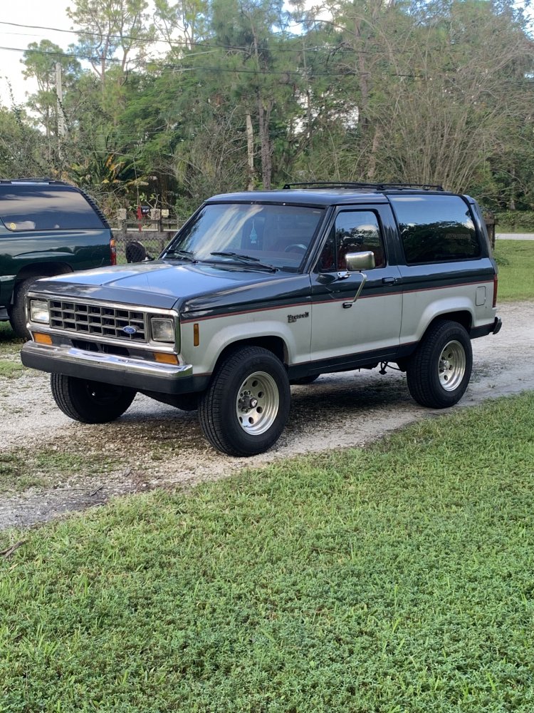

second gen with 5” suspension and 2” body lift on 35’s. No trimming and home made flares. 3” James Duff coils and axle pivots, custom radius arms (mine), F-150 spring perches and 2” Duff poly body lift.

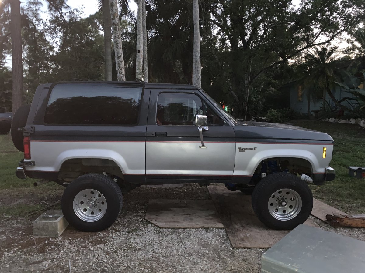

first gen with 2” skyjacker coils and 30’s. Mind the engine bay is pretty empty so it will sit a little lower once everything is back together. I’m adding a 1” body lift which isn’t in place yet. Also has custom extended radius arms (mine).
