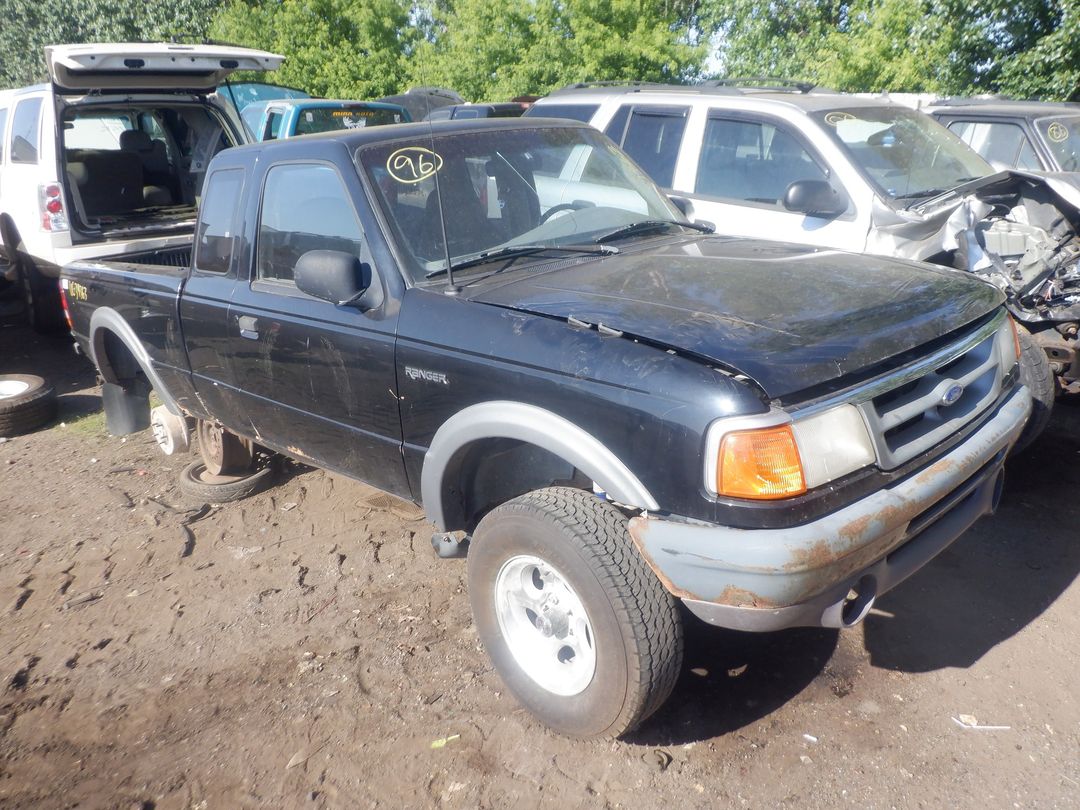

I found gray vinyl fender flares at the U Pull yard. I would like to put them on my Ranger. If I do I would have to spray paint them first with a rattle can. I know that Rustoleum, Krylon, and Duplicolor all make paints expressly for this purpose, but I am cautious about the results. Have you tried doing this before? And if so, how long can I expect a rattle can paint job to last? Also, it might be nice to my bumper black too.

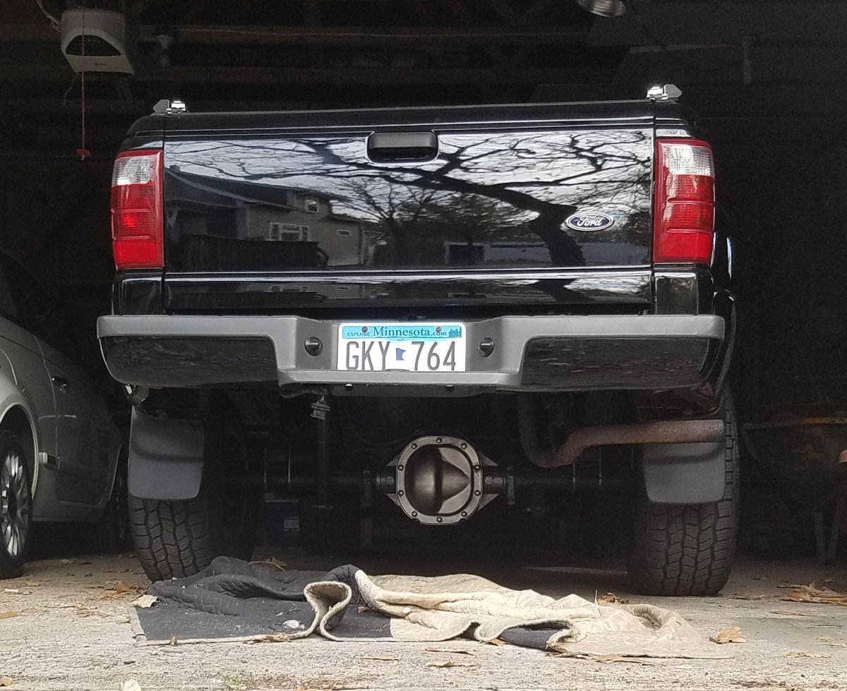

Also: soon I will pull off the bed and paint the frame with POR 15. As long as I am at it, i wonder if I should rattle can the muffler, catalytic converters, and the pipes. I've seen high temperature exhaust paints in the auto parts stores but wonder if they really work. I did this some years ago, but the paint did not hold up well at all. It didn't even last one winter. Have any of you had better luck?

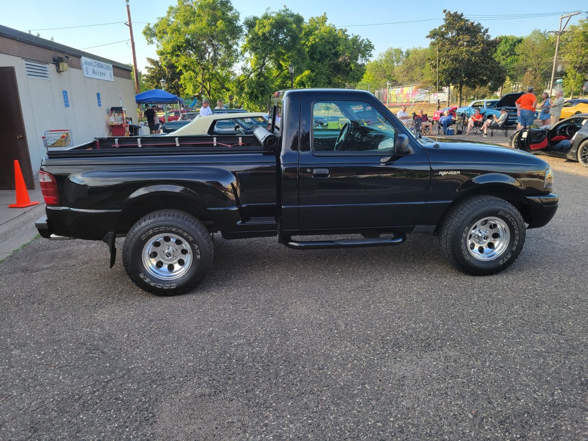

These are the flares I would like to pull and paint.
Is there a durable paint for this rubber bumper? This is an older photo. I have new dual exhausts which I wish to paint
I'm not sure how well the rear flares would fit.
You should also be aware of the holes you would have to drill in your trucks fenders and box. Then once you have then on.... the rust tends to a bit crazy under the flare.
thanks, Uncle Gumpa,
I'm not sure about the fit either. I can always return them or just hold them up against another old flareside in the junkyard. . i rather don't like the idea of drilling holes so I will try 2 sided 3M automotive along the outside and maybe a drilling a few small holes then use nuts and bolts with locktite on the inner edges.
I would not paint any converter. I have had mixed result using paint for plastics, if I was going to give it a shot I would use something from Eastwood with good reviews. I would paint an exhaust flat black and that is it. Just google
"how to paint aluminized steel"
which is what most exhaust pipe is unless you buy the cheap stuff from JCW.
