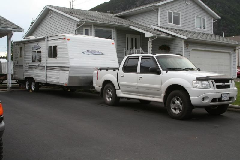

We loved our 05 when we had it! It was the 4.0L SOHC with the 5r55E and 4.10 gears. Comfortable, decent power, decent gas mileage and it did everything we ever needed it to do. I would not hesitate to buy another one. The 07+ are nice because of the 4.6L v8 option and bigger trans. I would not be worried about the IRS rear end in it, I've never had to do any work to one other than change the odd axle seal. And yes, they will pull 5000lbs with a weight distributing hitch.
We pulled our 24 foot 4800lbs dry weight travel trailer with it for a year and half, never had any issues other than don't expect to win any races.
