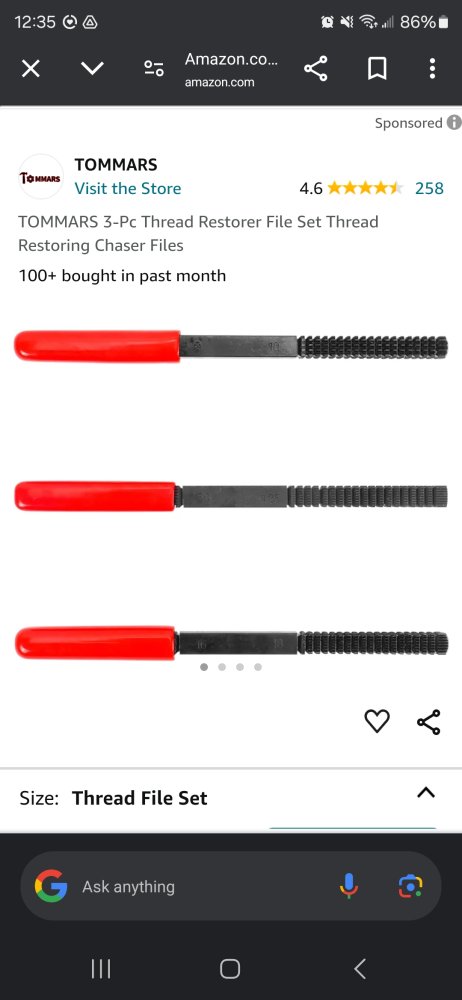

Is there any way to use a file or dremel to redefine the threads that are smooth? It wouldn't have to be perfect, just enough to help get the nut started.
You're talking about these threads?

With that Said, if there is enough good thread left past the damaged part, a thread file should be helpful. A thread file has teeth at the right spacing fir several different thread pitches. You pick the one that matches and carefully file the threads until they are cleaned up.

i was wondering if the flat part he referred too was the key way part.....i use a baby triangle file for my spindles.

I've used a triangle file many times. But it has the wrong profile. It will knock too much off the peaks before it reaches the bottom of the grooves. Still, much better than nothing and cheaper than new spindles, which I'm getting ready to order for mine due to bad spindle bearing journal surfaces.

Worked perfect, till it didn't. Got the spindle nut started once I redefined the threads. But then the nut would stop. Kept trying to file the threads and still no dice. What could be causing this?

This was the answer. I spent hours, filing. thread on the bolt, it stops, back it of a thread or two file. Rinse and repeat. It's better than new. Thank you for this
ahhh. so you mushroomed the end. we should have had you get real close pics. i would have likely suggested to flap wheel the bad part.
