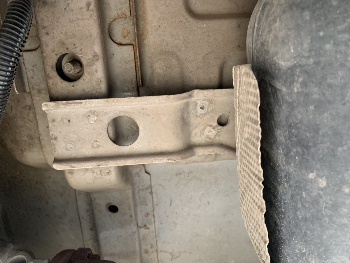

So I was thinking all fuel filters should be of the spin-on variety when I came upon the WIX 24770/NAPA Gold 4770 filter mounting base. Looking for a good place to mount it under my Ranger, I spotted this bracket. I do not know the function of this under floor bracket but it looked appropriate to me for attaching the filter mounting base.
72241

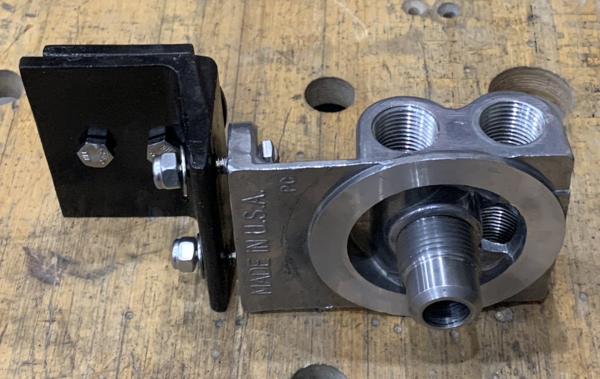

Then it was a matter of building an additional bracket to attach the filter mounting base to the under floor bracket as such:
72242
I attached the homemade bracket first and then the fuel filter mounting base.

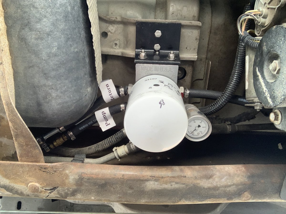

Except for the pain of splicing into the factory vinyl/PVC/nylon fuel lines, installation with the proper fittings was easy enough.
72243

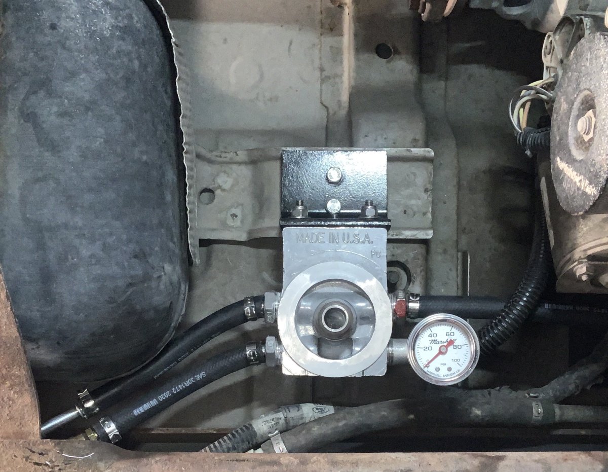

I added the fuel pressure gauge simply because I wanted on and the filter mounting base had one more port than was needed.

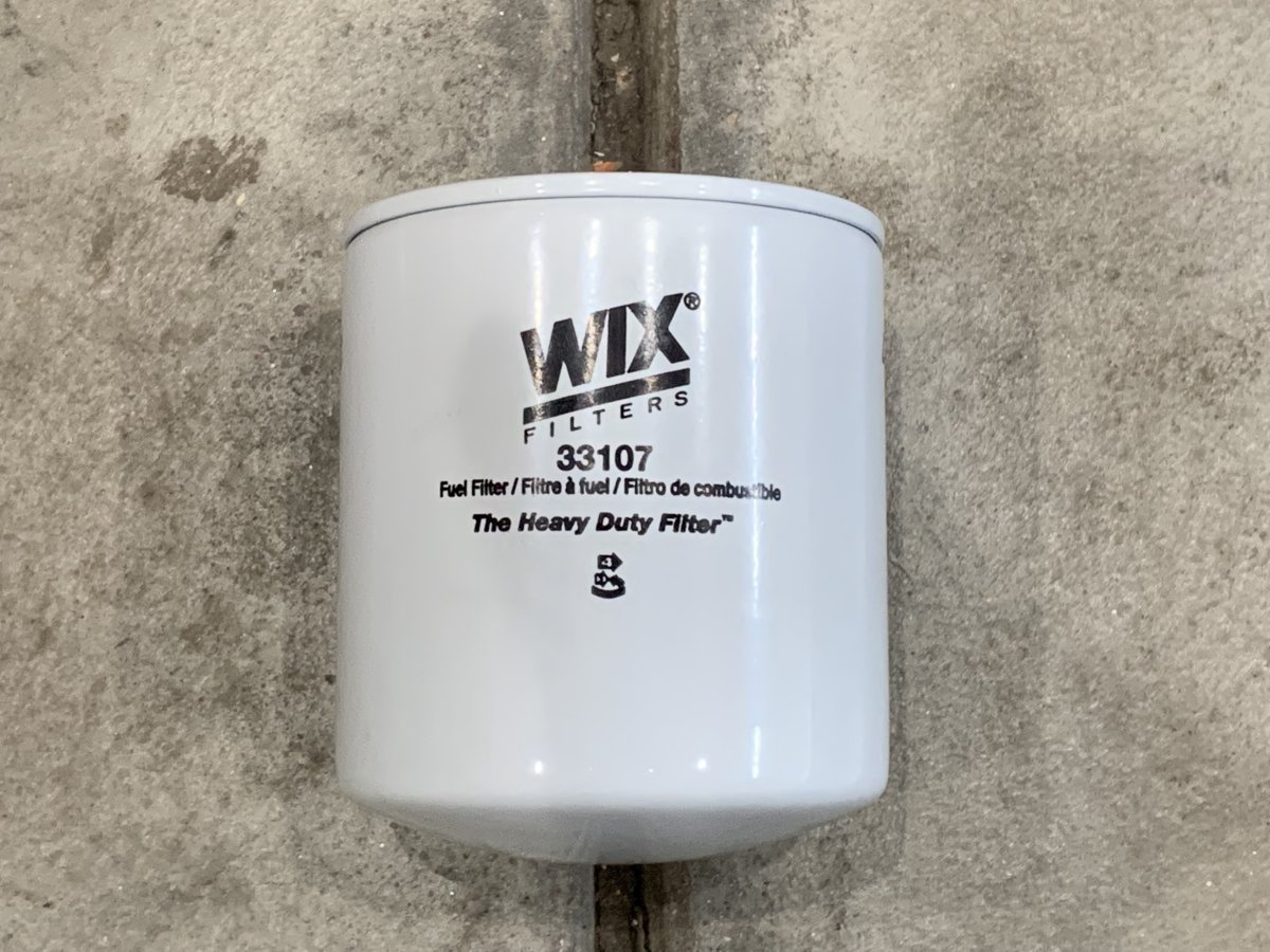

WIX technical support was very helpful and recommended this filter:
72246
And then the completed installation which has worked well since September 2021.
72247

I should mention that most fuel pressure gauges do not work accurately when positioned face down. I ended up replacing the cheap Marshall gauge shown in the photo.
Id run a line to inside the fuel filler door & put the guage there. not a lot of room but I think it could be squeezed in there.
