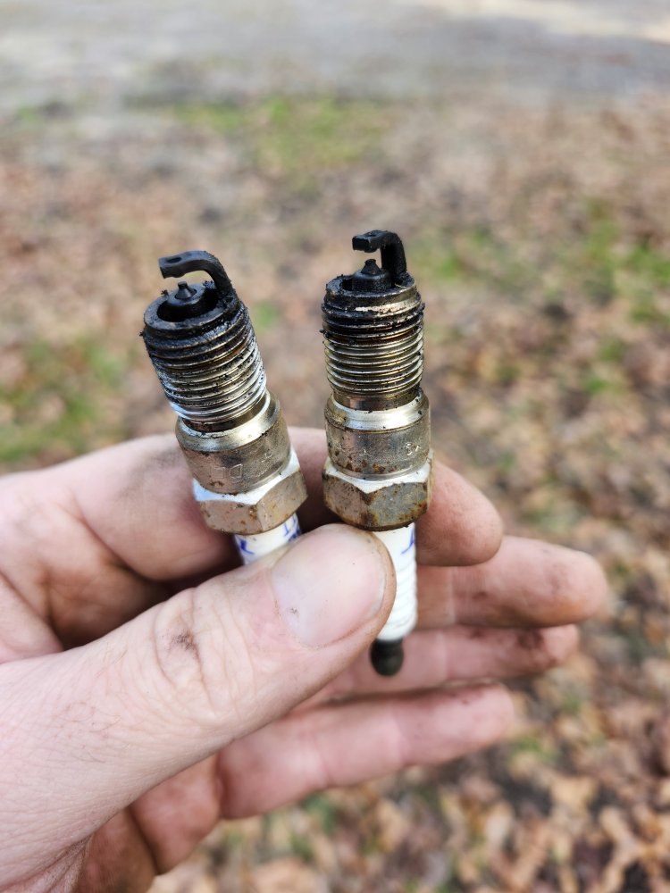

My 89 2.9 was running rough and I pulled some wires and found two cylinders that were not firing. Pulled the plugs on those two and they looked really rough.
What could cause them to be this bad?
Those look just about how I'd expect non-firing plugs to look. To my eye they're wet with unburned fuel and they've got a decent layer of carbon, either from partially burned fuel or oil burning. Have you pulled the other plugs to check? That might give some good clues. Also, which 2 cylinders were those? That might key someone in on something 2.9-specific. Good luck!
The plug gap looks too wide, if the wires are questionable that might cause problems.
Also, it’s usually recommended to stick with Motorcraft or Autolite plugs, double Platinum is good.
What is the condition of the cap and rotor? I’ve seen posts get carboned up or damaged and cause weak/no spark.

X2 on the too wide gap. Are they the correct heat range? Engine burning oil?
They were the standard range denso platinum plug but I'm going back with MC now. I'm not smoking or smelling burning oil so I don't think I'm burning any. They were gapped correctly when I installed them.

There is no 'standard range" for plugs and often aftermarket plugs approximate what manufacturers spec so they can use the same plug for different applications with no way to tell if they're actually the correct heat range. Many early 70's GM's would surge on the highway if Champions were used and the surge disappeared when AC's were installed. Whatever plug you buy, verify the gap is correct, the ones you removed were way too wide.

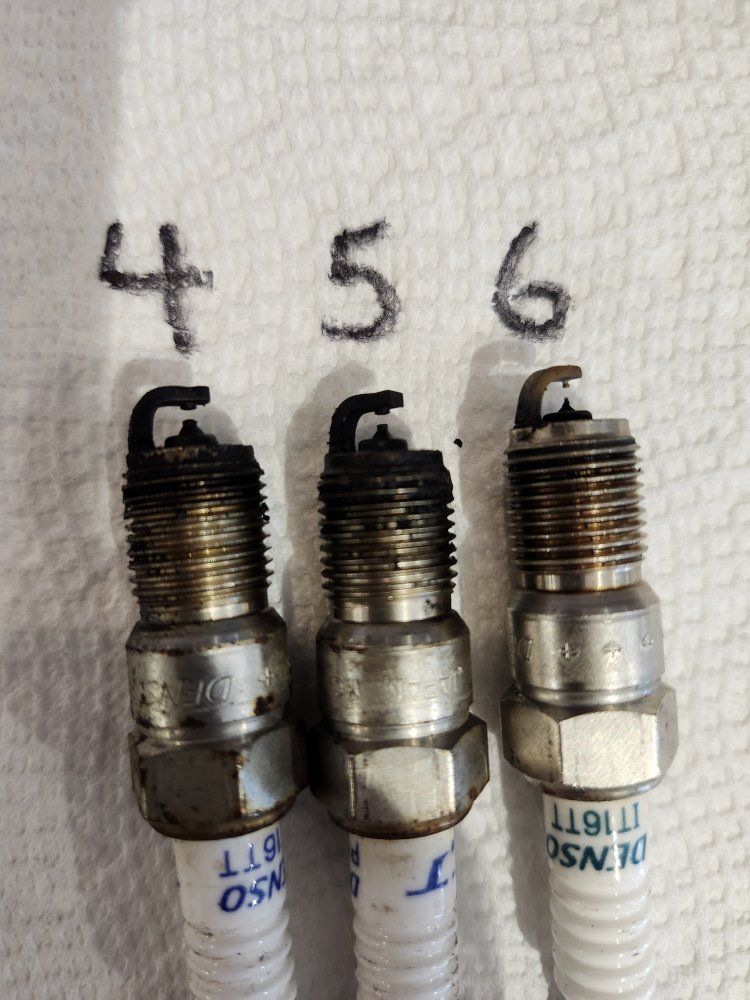

Pulled plug on cyl 6 today and it looked pretty rough too. Electrode didn't look right and I had dark oil wet on the plug in the threads. Put the compression guage on and it looks to be at about 120. I'll post pics tomorrow.
So my lineup so far. 4 and 5 look close to the same condition but 6 is degraded substantially andwas heavily oiled down.
So 6 was an iridium plug. Definitely not right. Will be changing everything out soon.
