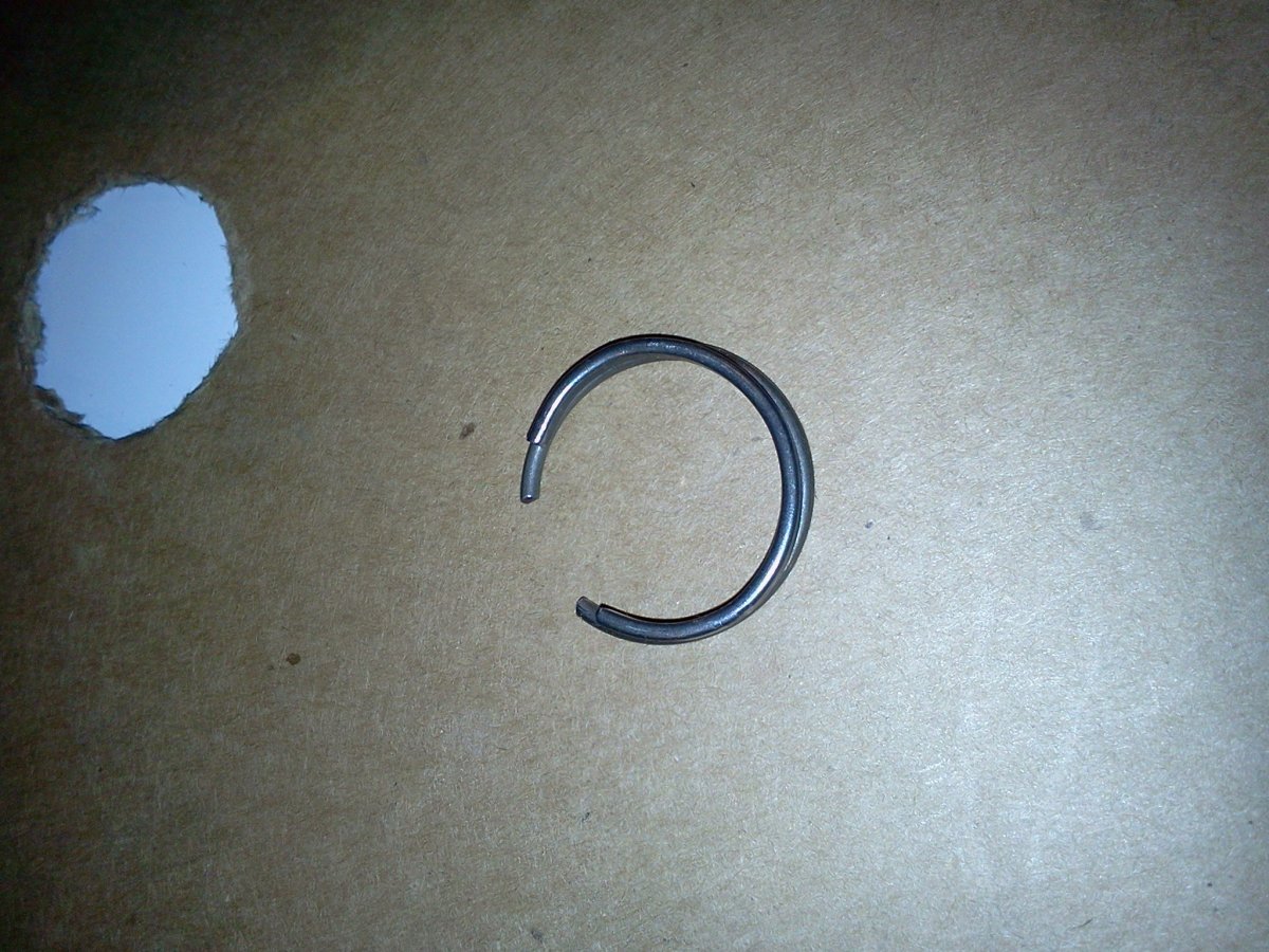

here is one from an intermediate shaft.
I pulled a couple from another shaft, they all are oval shaped. .093" / 3/32" wide.
I think they are supposed to be oval when new, not stretched during installation.
also the wire is sort of rectangular, the Trail Gear are round on both counts.

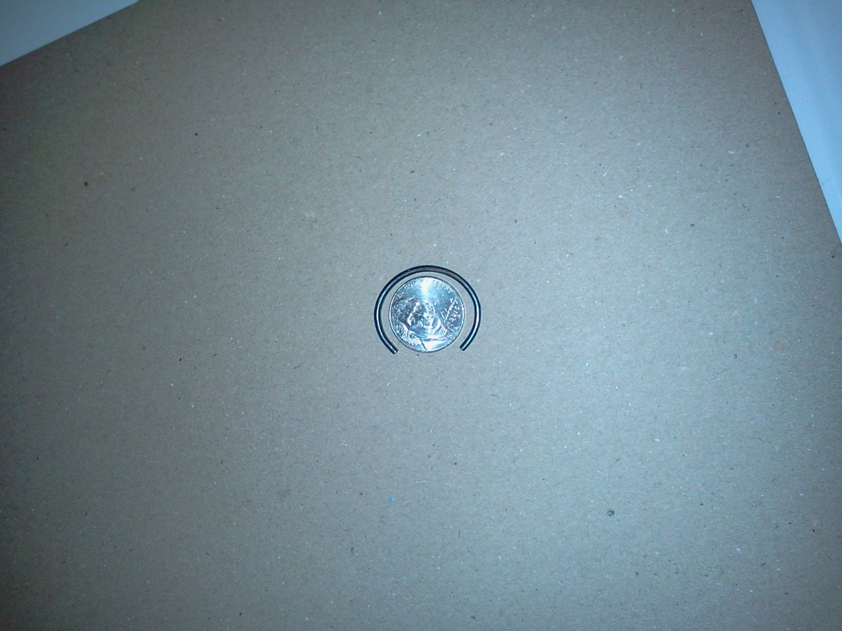

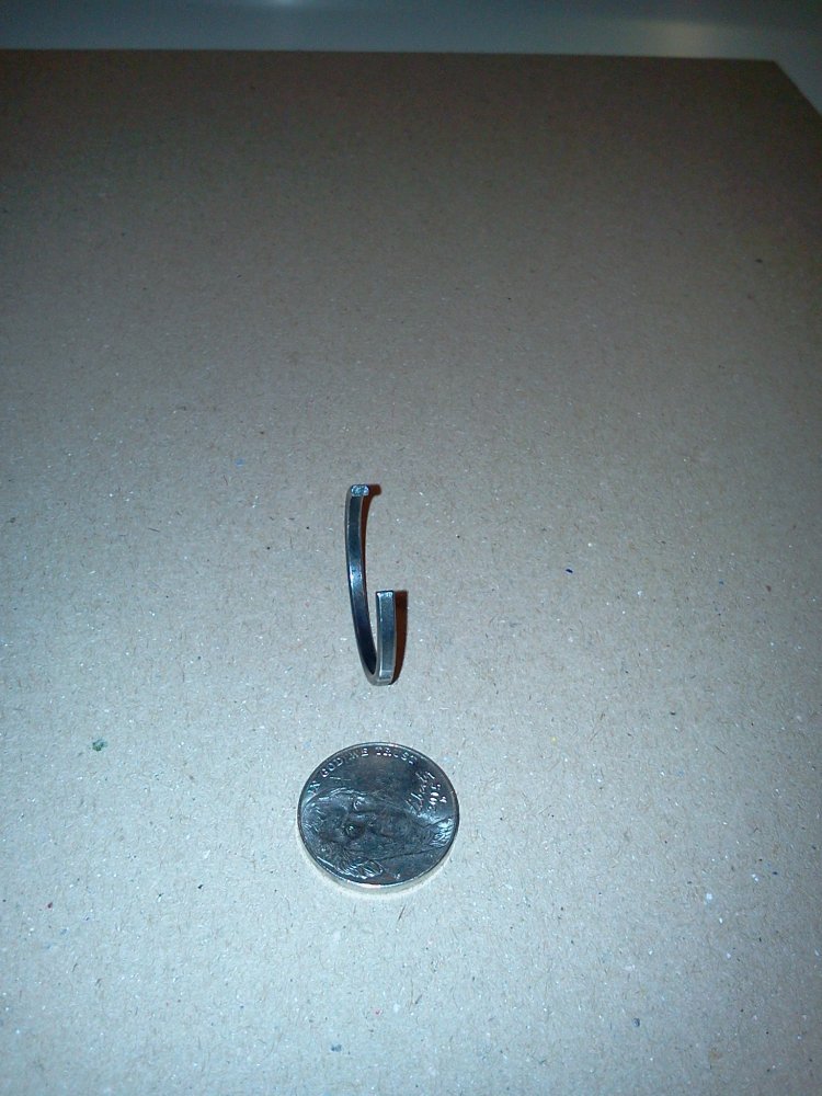

having nothing better to do today, I compared the 2 different rings.
Trail Gear wire is round, Ford is sort of rectangular. about .018" difference in width.
Trail gear makes a more complete & round shape.
slapped them both on an intermediate shaft and pushed a front diff on.
the (newer) TG ring fit tighter and being narrower resulted in about .012" more play.
it also locked the diff on better, so total thumbs up on the Trail Gear ring.

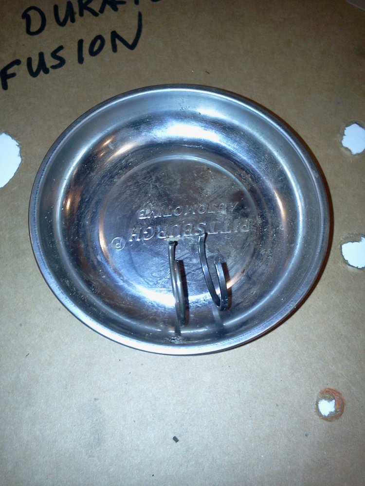

Ford ring on top.
the Jeep rings came in today.
05066064AA Mopar is exactly the same as a Ranger ring.
was less than $5
